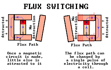

TESL@ said:
See this: http://helios.gsfc.nasa.gov/qa_gp_elm.html
NASA designed a boot using it, if I understand what you mean by "Leedskalnin discovery" correctly.
edit: It's called flux switching.
Didn't see anything on that page that seems to relate to this. I can show you a video right now where a guy made the device as Leedskalnin wrote in his little book. It was a U shape made of 1.25" square iron bar, each prong about 1 foot long. Two coils, one on each prong. He put the same type of bar across the prongs, energized the coils for about 1 second with a regular 9 volt battery and put it on a spring scale to see how much force was required to pull the bar off the prongs, with no power conneceted whatsoever. It took about 60 lbs of force. How do you explain that? How can 1 second from a 9 volt battery produce that kind of force after disconnected?
a) Lentz's law
b) residual magnetization
c) Magnetic fields can result in very strong forces when applied over a large enough area
Come on, I gave you the keywords just use ctrl+f.
Or look at this:
By magnetic "circuit" it is meant that the flux is "trapped" in the metal since it has high permeability.
By the way, it is not an electromagnet that works without energy supplied, it is just a permanent magnet now until the "circuit" is broken.

Okay, I'll look into this flux switching thing. You may be right. I was just trying to find the explanation. I didn't think it had been explained before. If you're right then I guess you met my little challenge. Thanks for the information then. I guess the fact that a burst of electricity comes out of the coils and will make a light flash when the bar is pulled off the prongs is explainable too, huh? The weird thing is that the coils won't light the bulb until the bar is pulled off, so it's not stored electricity in the coils like with a transformer. How is that explained? A burst of magnetism must occur in the prongs when the bar is pulled off or something.
That would be induction. The coils are in a magnetic field, and when you pull it away from said field, the total amount of magnetic flux through the coils changes, which in turn induces a voltage into the coils (Faraday's Law). In essence, the work necessary to remove the coil from the field gets converted into electricity.
