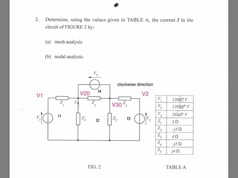

Hi I have this question as part of my assignment but cannot get my head around part b, I have worked out part a with an answer of -9.2+17.3i amps which from a previous thread I know is correct, but can't understand why the equations given in the previous thread are different to what I have.
Kirchhoffs current law
V20-v30=v3
((V20-V1)/Z1)+((v20-v30)/z2)+(v20/z4)=0
((v20-v1)/z1)+(v3/z2)+(v20/z4)=0
((v30-v20)/z2)+((v30-v2)/z2)+(v30/z5)=0

For the bottom equation, I think that middle term should be ##\frac {V2 - V30}{Z3}##. And that would be equal to the other two terms.
My mistake it should be divided by z3, but if I may ask why would it be ((v2-v30)/z3) instead of ((v30-v2)/z3)?
It depends on how you define your directions. If current is flowing into the node from z3 and out of it at z5 and z2 then ##v2-v30 ## is the difference and ## I,z3 = I,z5 + I,z2##
