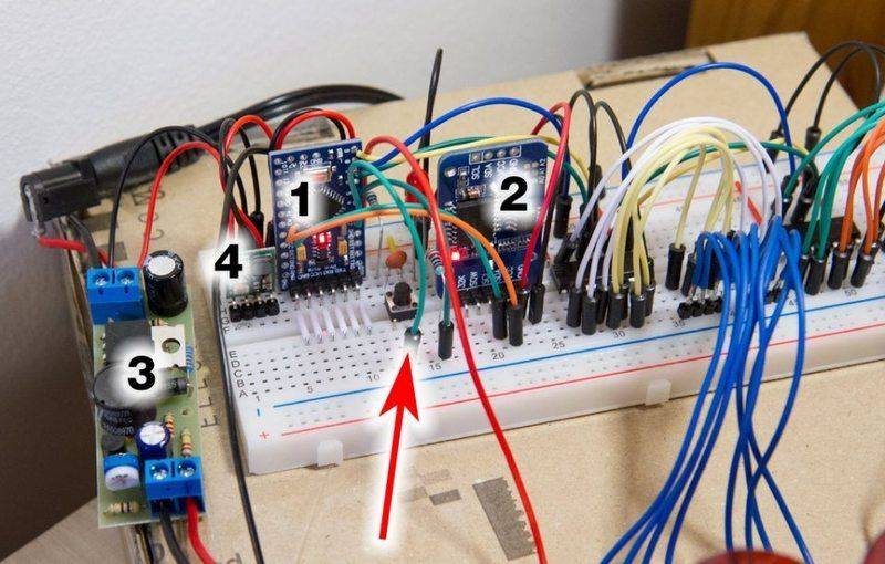

Not sure if I posted it here or elsewhere. I made a Nixie clock controlled with an Arduino. To make it possible to set the clock I have added a button connected with a wire. Pressed button generates an interrupt which I use to "round" the clock up or down to a full minute. The button has a capacitor added and some debouncing delay added in the code. It all works quite nicely, with one problem. Apparently now and then the wire acts as an antenna, producing false signals which shift the clock.
My first thought was to move the wire away from the 180V SMPS. It helped, but not completely. I will cut the wire to make it as short as possible (I am still on the breadboard, with Arduino Mini Pro sticking up, so I am limited in my options and the wire has to be hanging in the air for now), but somehow I am not convinced it will help get rid of the problem completely.
Any advice? What are my other options? Are there any standard ways of screening wires, getting rid of induced signals? I did some googling but didn't found anything obvious and easy to apply to my mess of wires. Chances are it is this mess that is a source of the problem and moving to a PCB (with a good separation of the Arduino/button connection and the high voltage circuit) will help, but I don't want to make the (almost) final version and risk it will still suffer from the same problem.

To make things more clear, that's how it looks (half of that is most likely like scratching the left ear with the right hand, but first, I didn't know better, and second, I used whatever I had/could easily buy/borrow):
1. Arduino Mini Pro
2. RTC (connected via I2C, green and orange wire in front)
3. SMPS 12V → 180V (for Nixie tubes)
4. SMPS 12V → 5V (Arduino, RTC, 2xSN74HC595N and 4x74141PC)
The red arrow points to the culprit wire connecting the button (mounted on the breadboard) to the Arduino.
On the right there are shift registers and blue cables (only half of them visible) go to the Nixie board (scrapped from some old voltmeter).

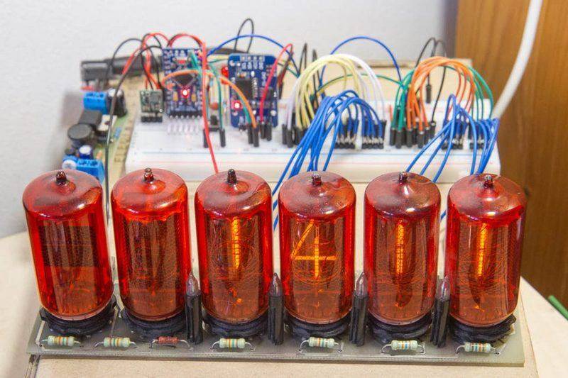

And the whole thing, about 20 minutes ago:
Maybe you could reduce the value of the pullup/down resistor that clamps the wire voltage while waiting for a key press.
Power will only be wasted in that resistor when you press the button.

Looks like you have a loop without a pull-up resistor?
What is the circuit of your button.

I had to check - it was grounded through 10k resistor. I put 1k there, we will see if it helps. These are completely random events, sometimes the clock works OK for several days, sometimes it shifts several times a day, so checking takes a lot of time.

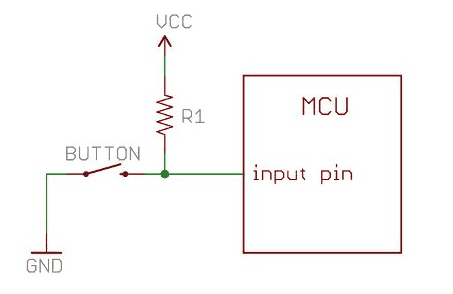

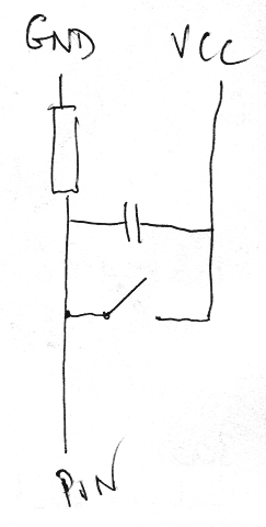

I admit I made the schematics several weeks ago (in other words:I don't remember details) and I am prone to errors (in other words: I don't trust myself, so chances are it is not a correct depiction of the circuit), but at first sight it looks OK to me.
There is a problem with the schematic. Pressing the switch connects a 1k resistor across the power supply.
Maybe you actually have the R1=1k0 in the Vcc line to C1 = 0u1F, not in the Gnd line.

Also your implementation of the switch is a little weird. This is a more standard way of doing it:
Looks to me like it is not different from what happens on the schematics posted by @lewando ?
My understanding is that my circuit gives HIGH on the pin, and when the button is pressed the signal is grounded, so the pin becomes LOW. It is the change that triggers an interrupt (to be more precise: the interrupt is configured to be generated on the RISING signal, when the button is released, but it doesn't change much).

But it is different, and lewando's is the standard connection method.
In yours, it appear the switch connects the labeled switch pins 1&2 to 3&4 when pressed. All that does is connect the non-GND side of R1 to Vcc. Pin 5 of U1 is connected to Vcc regardless of the switch position.
Wire it as lewando shows, and if the pin can be programmed with a pull-up, you don't even need the resistor. I've done exactly that with a ESP8266 board.

Bigger issue:
In other words, when S1 is closed VCC is still being applied to pin 5. Not sure how this would ever work.
A designer is often unable to see an obvious error in a schematic because they are blinded by their confident thoughts, not viewing the diagram as presented, through their eyes.

It is always a bad policy to put a capacitor across a switch as that generates EMI from the high current pulse when the switch closes. The 0u1F cap is really not a good solution here for de-bounce or EMI hardening. The solution is actually in the layout, by eliminating the loop currents flowing in the distant ground connection. The greater the area of the loop, the more EMI is generated, and the more noise is picked up. The signal wire loop area makes a loop antenna. That problem is typical of the “open” "rats nest" wiring forced by breadboards.
The open area between the ground wire and the green switch signal wire is the problem. The ground reference for the PB switch should come from close to the signal on the PCB and be twisted with the green signal wire. At the switch end there should be no connection to other ground conductors. Ideally, the pull up resistor should be at the chip end of the twisted pair. When the PB switch is pressed, the same current should flow in both wires of the twisted pair.

In order to help you, we need a correct schematic. As mentioned, the input pin is connected to Vcc regardless of switch position, so it can't possibly be wired like that and actually be working.
Sorry guys, I have checked with the board and the GND and VCC are reversed on the schematics (that is, pin is all the time connected to the GND through the resistor, and switch when pressed connects it directly to VCC).
I have modified the board as @levando suggested, getting back to 10k and removing the capacitor. Still works :wink: Another week to check if it will be stable.

Sorry guys, I have checked with the board and the GND and VCC are reversed on the schematics (that is, pin is all the time connected to the GND through the resistor, and switch when pressed connects it directly to VCC). ...
No, that's still not right. You need to make sure you know what you have there.
If I swap GND & Vcc on your schematic, that just keeps the input pin grounded all the time, the switch connects the resistor between Vcc & GND, but that has no effect on the input pin that the device sees. It's still grounded.
Follow what was provided earlier. Pull up Resistor connected to Vcc, other side of the Resistor connected to input pin, switch connected to input pin, other side of switch connected to ground.
A 1K versus a 10K or the built in pull up in the chip will provide better noise immunity, as was said above (The 1K being best if I wasn't clear here).

Sigh. You are right. Can't believe I made so many mistakes with so trivial thing :mad:
That's my original drawing from copying the circuit from the breadboard yesterday.
It was not a matter of GND/VCC being switched, rather the pin was connected on another side of the switch. That meant it was grounded through the R1 all the time (so LOW) an pressing the button connected it directly to VCC making it HIGH.
