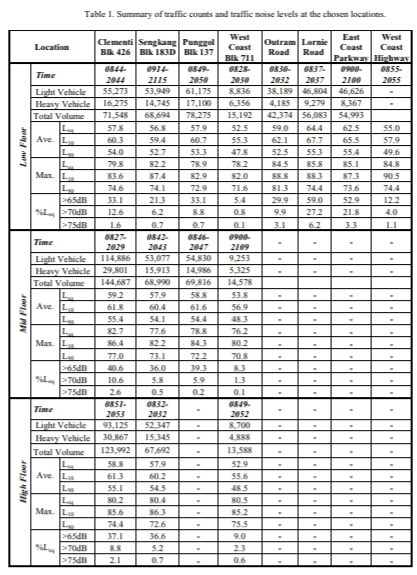

Here is some data. Only you can say what you can stand.
https://www.acoustics.asn.au/conference_proceedings/AAS2004/ACOUSTIC/PDF/AUTHOR/AC040085.PDF said:
The resolution is not the best. Follow the link to see it full resolution.
