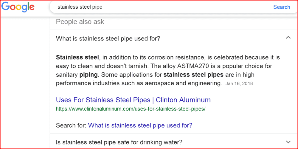

Maybe use stainless steel piping? It is probably not cheap, though...
