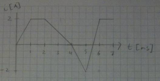

An inductor is subjected to the current in the graph:
L = 100mH = 0.1H
I) Calculate and graph the voltage over the ideal inductor.
II) Repeat for non ideal inductor with a resistance of:
RL = 50 Ω
[tex]U_{L}=L*\frac{di}{dt}[/tex]
[tex]U_{av}=L*\frac{Δi}{Δt}[/tex]
The voltage over an inductor is equal to the rate of change of the current through the coil.
I)
This is what I came up with. As an example, from 2 ms to 4 ms:
[tex]U_{av}=0.1H*\frac{-2A}{2*10^-3 s} = -100V[/tex]

*Is my square wave form correct? Should it be square, like this?
*Am I doing this correctly? It seems to me [tex]U_{av} = U[/tex]. So I could write just U =...

This is when I become confused, and I have spent hours and hours trying to solve this... sadly heh. I don't know where to start!
The way I understand it:
*Regardless of the internal resistance, the current will still be the same, as the coil and the internal resistance will be in series.
*So for charging up during 0-1ms, the voltage over the coil will be the same.
*Am I still going to have a square wave form?
I've been given as a clue that [tex]U_{coil}(3ms) = -50 V[/tex]
Please, just a nudge in the right direction, I'm totally stuck here..
Yes, all good assuming your algebra is right.
Yes you are but I don't even look at the Uav equation. What is important is the slope of i(t) at any particular time and in your graphs the slope di/dt is constant over periods of time.

That's right, you are shoving the same current through the non-ideal inductor as before. The outside current source will have to adjust its terminal voltage to accomplish this.

The non-ideal inductor is now modeled as a resistance in series with an ideal inductor. The voltage you measure across the non-ideal inductor is equal to the voltage across the ideal part plus ?
[tex]v_{real} = v_{ideal} + v_{R_{i}}[/tex]
Matching the variables to my drawing's labels:
[tex]v_{non-ideal} = v_{ideal} + v_{R}[/tex]
Alright, so the voltage from 2ms to 4ms is -100 over the ideal.
And the average current is 1 A. That makes the voltage over the resistor: R * I = 50 ohm * 1A = 50V.
[tex]v_{real} = v_{ideal} + v_{R_{i}} = -100V + 50V = -50V [/tex]
Is this sound reasoning? I think it is. What troubled me was the linear drop in the current, and I was having problems understanding how that influenced the voltage of the resistor... I think I get it now.

Yes :). But let's not look at the average, let's look at a specific instant of time.
Your hint was:
At t=3ms, the voltage across the ideal inductor is -100. The current through the inductor is (from your graph) 1A. So the voltage measured across the nonideal inductor is: Videal + iR = -100 + 50 = -50V, in agreement with the hint.
I just wanted to make sure you were looking at the current at a particular instant of time t=3ms instead of some average over an interval.
You can see that the voltage measured across the non-ideal inductor will be a scaled version of your i(t) graph (iR) plus the square wave voltage you found for the ideal inductor. So your squares are going to disappear except where the current is constant.
