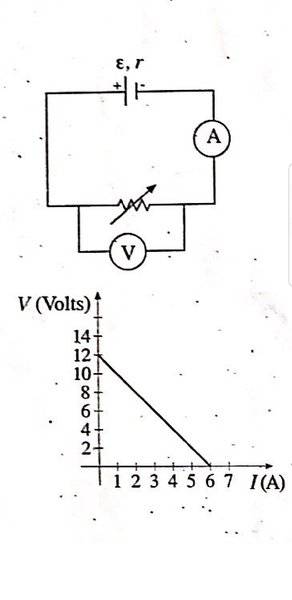

Someone did an experiment with an ideal voltmeter and an ideal ampermeter using the circuit in the picture, and got the graph in the picture.
-We know use an unideal voltmeter, how will the graph change?
-We know use an unideal ampermeter (the voltmeter is ideal), how will the graph change?
V=IR
u=V-Ir
The graph basically displays u=ε-Ir.
I figured that if the voltmeter is not ideal, the same current measured by the ampermeter will be "shared" by the voltmeter and the resistor, causing a higher value for the same current. In the answers they say it won't change.
Then, I figured that if the ampermeter is not ideal, the value will decrease quicker, becuase now u=ε-Ir-IR, this one doesn't have an answer.
Where is my mistake? Am I right?

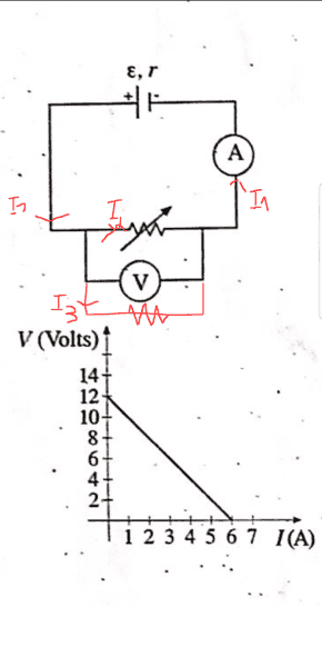

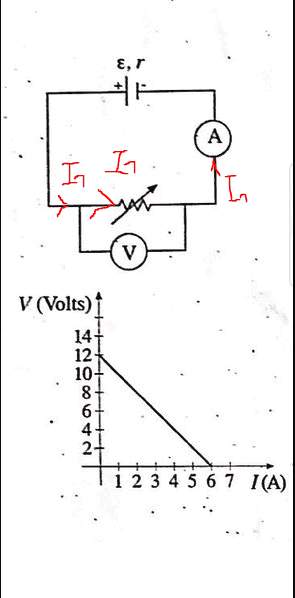

What I don't understand is, why doesn't this happen:

The question remains...

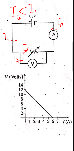

Hint: Two resistors in parallel always have a combined resistance lower than either of the individual resistors. So the current in the circuit will increase.
It will, but I am talking about how different would a certain point be on the graph for the SAME current. This is what the graph shows, no?
Ok I missunderstood what you meant by same current.
If you replace the ideal volt meter with a non ideal meter AND readjust the variable resistor so the current stays the same THEN the voltage drop through the battery resistance r will be the same and so the voltmeter reads the same.
It's worth thinking about the case when the current = 0. With an ideal meter this occurs when the variable resistor has infinite resistance. With the non ideal meter the total resistance can't be infinite because of the meter resistance. If you assume the meter resistance >> than r this can be ignored. But this isn't always true. For example if the battery was actually a capacitor r would be quite large.
