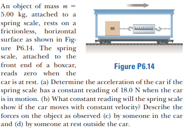

For part (c) of this problem,
The solution is,
However, how did they know that the fictitious force that acts on the mass until the string become taut (T = Ma from as observed by an observer at rest outside) has a magnitude of Ma (assuming that the observer has no communication with the outside observer)
Many thanks!
Many thanks!
Someone in the car can only see how much deflection occurs in the spring scale.
That person is unable to see the increasing velocity of the object or the boxcar.
Therefore, a direct measurement of the acceleration can't be made by that person.
Likes member 731016
The observer in the car has to have some way of figuring out the acceleration of the car. Note that they have no way to distinguish a literal acceleration from a constant horizontal gravitational attraction. This is part of the reasoning behind Einstein's GR theory.

Thank you for your replies @Lnewqban and @haruspex !
I guess we could go as far as saying then that there is no way to tell from an non-inertial perspective inside the carriage that there is a fictitious force acting at all. From their perspective it is a very real force, correct?
Many thanks!
Many thanks!
In GR, gravity is considered a fictitious force because, like acceleration of the frame, it depends on the mass of the object being acted on. Real forces should not depend on that.
Likes member 731016
Many thanks!
Yes. Furthermore, the person inside the train will be under the impression that the "floor" on which the mass rests is an inclined plane. That's because a plumb bob hanging from the ceiling defines the local direction of "down". When viewed from the inertial frame of the ground, the plumb bob will not be perpendicular to the floor, but will be slanted back. Thus, the "down" direction for the person in the car is not perpendicular to the floor. Also, the body of the person must be aligned with the plumb bob and lean into the "incline" to avoid being toppled over. The effective weight of the train rider is the vector sum ##m\mathbf{g}+m(-\mathbf{a})##.

That is very interesting what you mention about the person having to a higher effective weight. But I guess if the acceleration is purely horizontal in the train's case the normal force from the floor dose not have to increase, correct?
Many thanks!
Callumnc1 said:
Thank you for you reply @kuruman !
Many thanks!
The normal force from the floor does not change, but the person now experiences 'gravity' as being at an angle to the floor, and increased in magnitude.

You confused force with acceleration. If you are in a car that accelerates forward, then the force you experience is in the forward direction. If something isn't accelerating with the car, then in the reference frame of the car, it is accelerating in the opposite direction. You then must add a fictitious force to explain the relative acceleration in the non-inertial frame.
