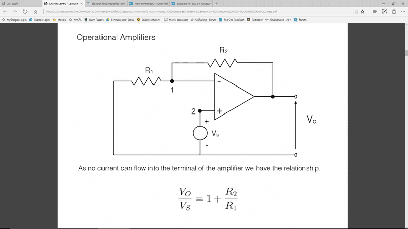

(c) This is the part I have trouble with.
There is three resistances. The only equation we have used before for non-inverting op amps is
Vout/Vin = 1 +R2/R1
Vin = 8V
R2 = 80K
I'm guessing the 6.8k resistor is part of R1 with 20k but I'm not sure how to add it...
Given your first stated assumption about ideal op-amps, what effect do you think the 6.8 kΩ resistor is going to have on circuit behavior? (Think about how much current can flow through it and what potential drops can occur across it)
There's another assumption that can be made about the behavior of ideal op-amps that is tied to your third listed assumption, that of infinite amplification. What assumption can be made about the potential difference between the input terminals of the op-amp (when the circuit provides negative feedback, of course)? Can you analyze the circuit to determine Vout for a given Vin?

Is it that the current that could potentially flow through the resistor just be is V/R, in this case 8/6.8 approximately 1.18 A ?
Think about it. If the input resistance is infinite, how much current could flow through the 6.8 k resistor and into the input?
Is that that V- = V+ ? So there would be no potential difference between the two...
Yes!
As in nodal analysis? I' not sure how to do that with the op amp in the circuit...
Could use nodal analysis, yes.
Strangely enough the op-amp being there actually simplifies things:
1. Infinite input resistance, so no current drawn from the nodes they're connected to.
2. Input terminals at the same potential, so if you know one voltage you know the other, too.
Can you determine the potential at the +input terminal?

QUOTE="gneill, post: 5632418, member: 293536"] Think about it. If the input resistance is infinite, how much current could flow through the 6.8 k resistor and into the input? [/QUOTE]
Well, V = IZ, so if Z is infinite then I has to be 0 ?
So, could I treat R1 just as 20 k and use it in the above equation?
Yes. So that input resistor has no effect.
I suppose so. You haven't specified exactly where R1 and R2 are or shown why you've chosen the formula you did, but as it turns out, your choices are fine.
Ok, but isn't it from nodal analysis that the equation Vout/Vin = 1 +R1/R2 comes from?
So, could I use that or do I have to derive a specific one for this circuit?
Well, the equation certainly can be derived using nodal analysis, but there are other ways too. You can use the formula if you're sure it's applicable (it is in this case). But you should always be prepared to derive the formula for a given circuit. Sometimes you'll be given a circuit that isn't exactly like one of the "standard" layouts and you'll have to do the work. And, you could always suffer a memory lapse and forget which formula applies in a given situation. You should be prepared to derive it quickly.

So in this case Vout = (1 + 80k/20k)(8) = 40 ?
Yes indeed!
