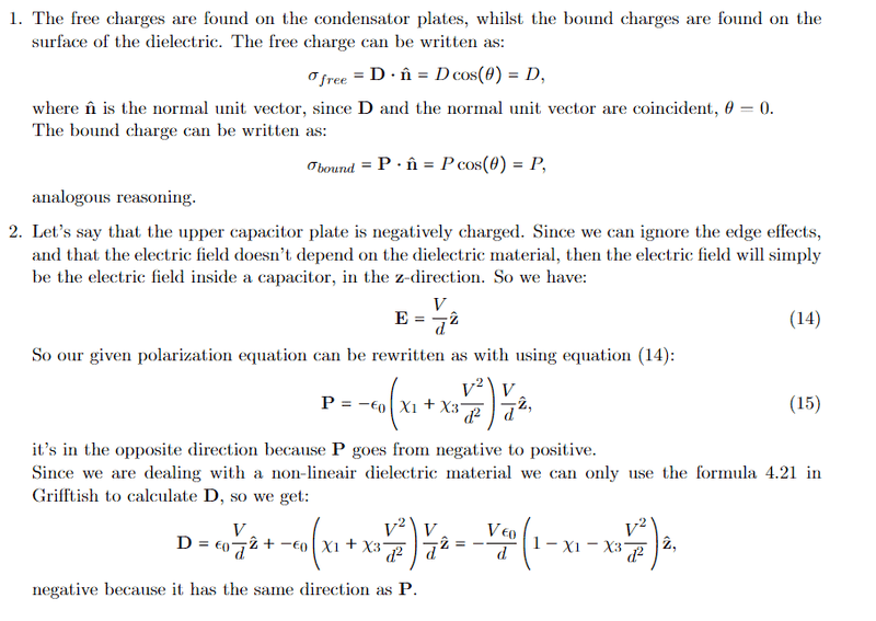

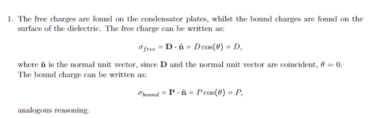

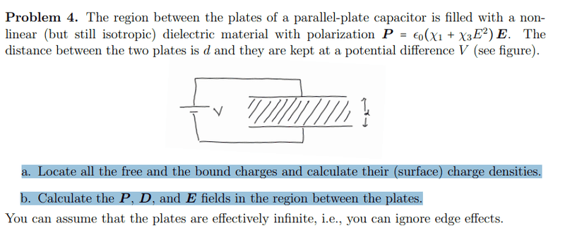

a. Identify the location of all the free and bound charges present in the region between the plates of the parallel-plate capacitor, and determine the surface charge densities associated with them.
b. Determine the values of the polarization (P), electric displacement (D), and electric field (E) in the region between the plates.
See solution.
Question:
Solution first part:
Have I done it right?
I don't know how to begin with second part since the dielectric is non-lineair, and most formulas like $$
D=\epsilon E$$ and $$P= \epsilon_0 \xhi_e E$$, only apply for lineair dielectrics. What to do?

You're told how [itex]\mathbf{P}[/itex] relates to [itex]\mathbf{E}[/itex]; the question states [tex]
\mathbf{P} = \epsilon_0(\chi_1 + \chi_3E^2)\mathbf{E}.[/tex] The definition [tex]
\mathbf{D} = \epsilon_0\mathbf{E} + \mathbf{P}[/tex] does not assume a linear relationship between [itex]\mathbf{P}[/itex] and [itex]\mathbf{E}[/itex].

This is my new solution:
Are these correct?

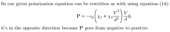

From the relation ##\mathbf{P} = \epsilon_0\left( \chi_1 + \chi_3 E^2 \right) \mathbf E##, shouldn't ##\mathbf P## have the same direction as ##\mathbf E##?
You say that "##\mathbf P## goes from negative to positive". Can you elaborate on this? Which positive and negative charges are you referring to here?
Doesn't polarisation go from negative charge to positive charge, whereas electric field goes from positive to negative?
Omg I mixed up direction of dipole moment with direction of polarisation, sorry.
