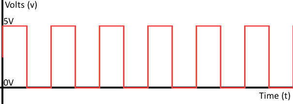

What do you mean by that last part? If I go on my computer I can play a square wave out of its speakers.
Oops. Typo. I meant 'has no resemblance to a sine wave'
However, you can play square waves through your speakers. The higher the frequency the more it will sound like a tone (but it will never be one). Go to http://onlinetonegenerator.com and play 50Hz as a sine wave and a square wave, you will see the difference. Move the frequency down to 5 Hz. You will be unable to detect any sound as a sine wave. Try that as a square wave, and you will hear individual pulses. For the square wave, what you are hearing is the rise and fall. Set the square wave frequency to 1 Hz and you will hear a pulse of sound every half second. That is the rise, then the fall of the square wave. There is nothing in between them because sound requires change to be propagated - no change in pressure, no sound.
For a sine wave there is constant change of pressure, but at these frequencies your ears cannot detect the change.

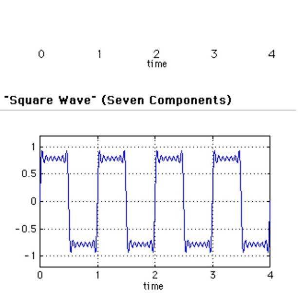

It might not look like a sine wave, but isn’t it composed of a finite number of sine waves, and have an appearance that shows that? I thought the square wave was saved digitally as a perfect square wave, but came out of the speaker as a sine wave composed square wave. I attached pictures of what I mean by that.

View attachment 207802 View attachment 207803
There are two ways to make a square wave. One is to generate an infinite number of sine waves of different frequencies and superimpose them. The other is to turn a switch on and off. Turning the switch on and off does not generate any sine waves.
Although you can construct a square wave from sine waves, the process is not commutable. If you pass a square wave through a filter and sine wave modifier, the only sine wave you will get will be at the frequency of the square wave.
If the sine wave is not pure (as in the case of your above example) you will be able to extract the 'ripple' frequencies.
In the case that the square wave is saved digitally as a pure square wave, it will come out of the speaker as a pure square wave subject to the constraints of electro mechanical response times (and , as FSscheuer said, loud speaker system distortions etc). Basically, the rise and fall times will become slower. As the frequency of the square wave increases, this distortion is a larger part of the waveform, resulting in the waveform moving towards a typical sine wave like form although it will not become a pure tone. That is why Digital audio devices use a digital to analogue converter at the output.
Just as an aside, we said before that you can construct a sine wave from an infinite number of square waves (integration) but think of the implications - if you can construct a square wave from an infinite number of sine waves (of different frequencies) and you can construct a sine wave from an infinite number of square waves...

In your post #12 the seven component square wave, the portion between 0 and 1 on the time axis is the wavelength and contains one cycle, which is repeated. If new assume that the time axis is in seconds, the frequency of the wave is 1Hz.
