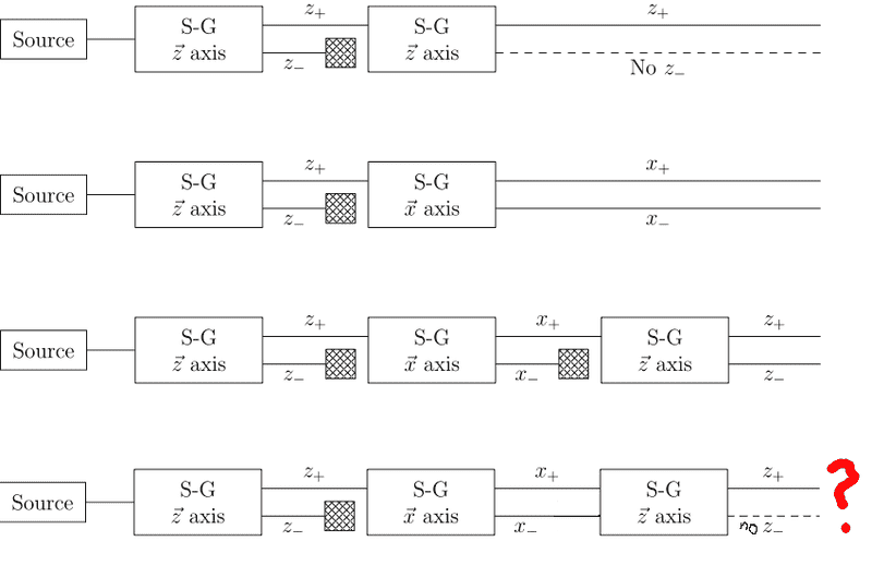

A. Neumaier said:
The difference becomes visible when you manipulate the system before measurement, e.g., in a Stern-Gerlach experiment by changing the external magnetic field.
I think that I understand, and I have a question about this experiment.
Say we have a stream of silver atoms flying along our Y axis. Their spin, measured along any axis, will take on one of two values.
We set up a magnetic field along the Z axis, so that depending on the particles' spins, they will end up in one of two locations. We collect the particles from one location and pass them through another magnetic field along the X axis, so they again end up in one of two locations. We collect the particles from one location and pass them through another magnetic field along the Z axis.
If their spin along each axis were merely a mixed state, we would expect them to finally land in only location. Instead, they land in two again. This is because our measurement of their spin along the X axis changed their state, putting their spin along the Z axis back into a superposition.
Question: If, in the middle apparatus, we do not block one of the streams, but let them both through, then will they wind up in only one location at the very end? (I've illustrated this question by modifying a picture I got off Wikipedia)
The figure is ambiguous as the magnetic field deflects the beams, and the effect of the field on the beam depend on the relative angle. But if you do the same experiment with light and polarization filters, there is no ambiguity and the answer is yes.
