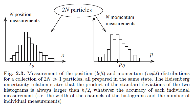

I am taking note that in fact the uncertainty relation can be deduced mathematically from the inequality relationship of Cauchy-Schwarz. This demonstration is clear, but its pratical setting up remains unclear to me.
If I prepare a system repeatedly in the same state and then I measure repeatedly A, I can calculate ΔA. Then an hour later I prepare the same experiment repeatedly in the same state and then I measure repeatedly B I can calculate ΔB. In this situation the relation
[tex]\Delta A \Delta B \geq \frac{1}{2} |\langle [\hat{A},\hat{B}] \rangle|[/tex] is always verified ?
Best regards
Patrick
Yes, you summarized the meaning of the uncertainty relation in a very clear way. Also the excerpt from your source (textbook?) is very good. Which one is it?
