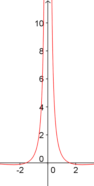

Hi !
the integral doesn't converge for x tending to 0.
The response of WolframAlpha is correct.

I am surprised to see the message from WolframAlpha for with Mathematica I could get -2.97 as the answer.
In any case (divergent integral as you say or negative area under the curve as I found), my point is if you look at the curve of cos(x)/x^2, you can see a definite area under it. I don't understand why wouldn't this integral converge or return a positive value.

You can't just evaluate this integral the way you have because you have a singularity at x = 0. If you try and integrate it normally then you are going to get a nonsensical answer.
Basically the reason in a nutshell is that at x = 0 you'll get a vertical asymptote. If you don't understand go to Wolfram Alpha and graph your function.
I don't know what is going on with Mathematica.
However, why would you expect to get a finite number out of this integral? Would you ever try to integrate .5/x^2 over this interval? I hope not. The integrand blows up at zero so you get an integral that does not converge.
Also, 0 is not a singular point of the function. The function is not defined at x=0. An example of a singular point would be something like x=0 for the function f(x) = |x|.
You have also made an error in you excel file. In the column labeled "x^2" you actually have 1/x^2 so then when you divide cosx by 1/x^2 in column D you are really getting cosx * x^2. I changed col D to B*C and the graph and the trapezoid integral changed to what it should be.

It will "converge" in your excel file (even if you correct it as I did), but this is just a reflection of the fact that you are not sampling the function at x=0, which is where the bad stuff happens. If you change the value in A12 to 0, then the trapezoidal estimation blows up, as it should.
Big mistake ! This is not true in case of x close to 0.
The "area unter it" becomes very big, even for very small distance between two values of x.

The integral "clearly" diverges, as previously stated. you should really have made a better drawning.
