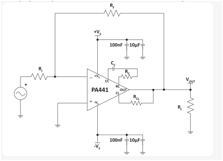

There is no need to be so snarky. Here is a schematic of my circuit. The problem is that increasing the resistance of the load is causing the gain to fall to basically unity, not that the circuit does not function at all. It functions fine in exactly the same conditions with a smaller load. To test it, I am using an ohmite SM108035007FE 5000 Mohm resistor, so I believe there should be no capacitance or inductance, correct? Except perhaps some effect from the oscilloscope?
I left out RL (the resistor in parallel to the load) because it's function did not make sense to me.

Hi! Would you be okay with showing which values you are using for each component?
There are a few words in the post that are having me feel a little bit twisted and I'd like to understand the problem better. I personally call the op-amp in that image as inverting, but you called it non-inverting in the OP; I also call ##R_L## the load resistance, and so when you say that you've increased the load resistance and removed ##R_L## I have a difficult time understanding which resistor you are talking about.

Have you checked the output voltage drive circuit compliance? My initial suspicion is that you are hitting the output rails as you increase ##R_L##
The question is theoretically does anyone know of a situation where increasing the resistance of the load on an op amp would lower the gain. In theory, it should require less current.

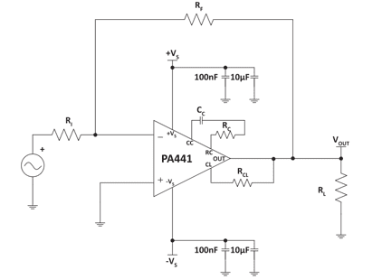

You said you use PA443 in your first post, then you show the schematic of PA441 straight out of the datasheet. You don't show any value, the current limiting resistors Rcl. How do you want anyone to help you?

BTW, your thread title and this statement say that you are using a non-inverting opamp configuration:
mlamont1 said:
The amplifiers are set up as noninverting with a gain of 22
But the schematic you posted is of an inverting opamp circuit:

I noticed the mistake with the "non-inverting" with the "inverting" schematic (post #4). After some thought even if they got it swapped up the magnitude of the gain would still be pretty close. Let's they were expecting the gain to be ##22## when they used "non-inverting" formula they looked up somewhere; this would be mean that the feedback resistance would ##21R_{I}## they would look at the oscillope and see their sinusoidal has been amplified a lot (almost 22 times their input) and say it's working without careful measurement or noticing that it has been inverted. They did say it "worked" with lower "load resistance."
And I'm still wondering how he got a 5000Meg load while looking at it with a 10Meg 'scope probe! (or so he indicates in the Original Post)
Could he have confused the load resistor as the feedback resistor? That would explain a lot.

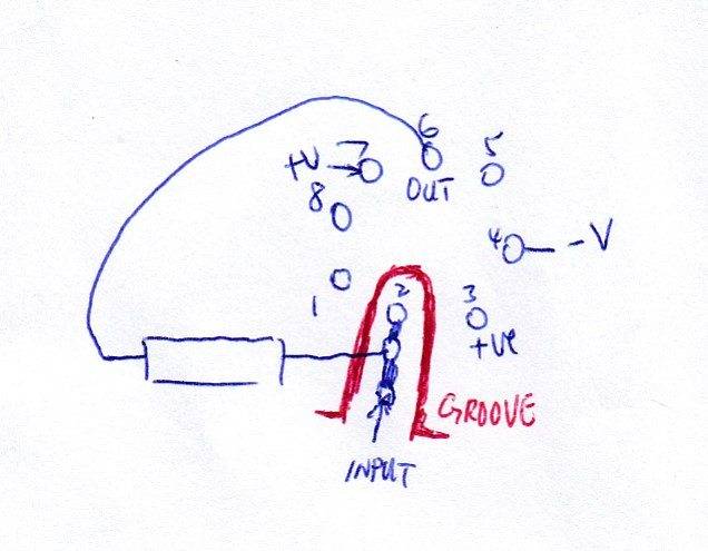

yungman said:
It's a different mindset in design, how the pcb layout, special cleaning method for circuits
Did you use FR4 for the boards?
  • #31
It's better to use teflon or other special material, technique using guard ring also common, BUT I actually cut groove around the critical junctions ( actually cut all the way through) on the pcb to avoid creepage. I have been using this technique for high impedance and high voltage isolation. There's similarity between the two, surface creepage is a very a important thing. This technique allow me to use cheaper material and not as critical in cleaning...I am born cheap,cheap is my middle name!
I used round can opamps at the time, I created footprints that had pins farther apart so I can cut groove around pin 2 ( this is standard pin out of opamps, 2 is -ve input, 3 is positive, 6 is output, 4 is -V, 7 is +V). I made the trace of the -ve input as short as possible as shown. I layout my own pcb, I don't want to hear complain from the pcb designers that it's too hard, too much trouble... From my experience with HV, high impedance and high speed RF, pcb layout is where you win or loss the war, I layout all my pcbs.
Some people use standoff for the -ve input of opamp too. I tend NOT to do that if I can help it. Cost money to custom assemble.
