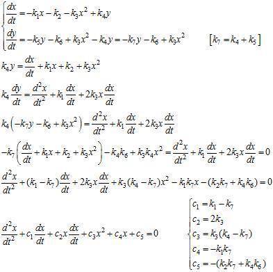

Hi !
The system can be reduced to a second order non linear equation, which is too complicated to be solved analytically, on my opinion.
Thank you very much for your reply. I will try to make use of numerical solution then.
