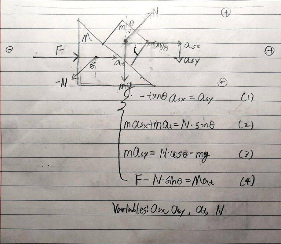

We have a wedge whose surface is ##\theta## from the horizontal surface. After a block is placed on its frictionless slant surface, the wedge starts to accelerate due to a force F. What is the normal force acting upon the block?
I have been trying to solve it but I got no clue. Could someone give me a hint?
First step: draw separate FBDs for the two components, showing forces. Next, create variables for the accelerations. Third, write the ΣF=ma equations and any appropriate kinematic equations that express relationships between the accelerations.
For that last, you need to represent the fact that the block stays on the wedge surface.
Likes Leo Liu
Hi. The constraints in this problem gives these four distinct equations. Could you tell me if they are correct?

Is asx the horizontal acceleration of the block in the lab frame or in the frame of the wedge?
If you define the height and leg of the wedge as ##h## and ##\ell##, then the net force on the block in the wedge's reference frame is in the direction of ##(\ell, -h)##. Since we know that the net force's norm is ##g\sin\theta##, we can describe it by ##\vec f_{b|w} = \frac{g\sin\theta}{\sqrt{\ell^2+h^2}}(\ell, -h)##. I think that this might work (you can find the block's absolute acceleration from this since you know the wedge's acceleration).$$\vec a_{b|w}=\vec a_b-\vec a_w$$The block starts falling from the top, so i think that it okay that we are considering the whole wedge to be only the topmost point (so that ##\vec x_b(0)-\vec x_w(0)=\vec y_b(0)-\vec y_w(0)=\vec 0##).
The frame of the wedge; since it is an non inertial frame, I added the acceleration of the frame to get the real acceleration.
Then it all looks fine.
