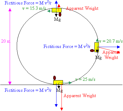

Yes, the normal force depends on the velocity of the object.
But that normal force is a reaction to the centrifugal force, which is a ficticious force induced by the circular movement.
For the object to press on the loop at its top (not falling from it), its velocity must be such that the centrifugal force (always pointing out the loop) is greater than the gravity force at the top angular position.

Lnewqban said:
But that normal force is a reaction to the centrifugal force, which is a fictitious force induced by the circular movement.
This makes sense, but the fact that the normal force can be a reaction to a fictitious force just doesn't sit right with me. Does this mean that you don't need a real force for normal force to respond?
You have a choice of any number of reference frames.
If you choose the rotating frame centred always on the object then to correct for its acceleration you have to introduce a centrifugal force on every object in the frame. Within that frame, it is just like a real force; and in that frame the object is not accelerating so something has to balance the centrifugal force.
If you choose an inertial frame then the object has an acceleration normal to its velocity so the net force must have a component normal to the velocity. We call this component the centripetal force, but that is all it is: it is not an additional applied force.
