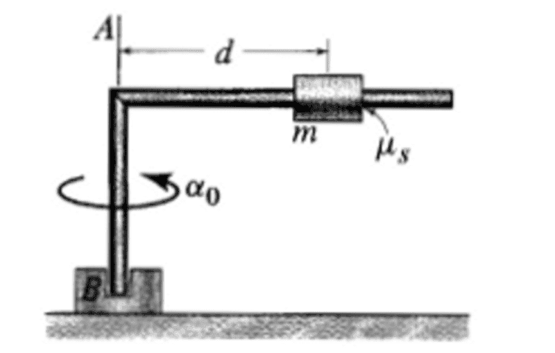

The system shown is initially at rest when the bent bar starts to rotate about the vertical axis AB with constant angular acceleration a 0 = 3 rad/ s2 . The coefficient of static friction between the collar of mass m = 2 kg and the bent bar is f.Ls = 0.35, and the collar is initially d = 70 em from the spin axis AB.
1)Assuming the motion starts at t= 0, determine the time at which the collar starts to slip relative to the bent bar.

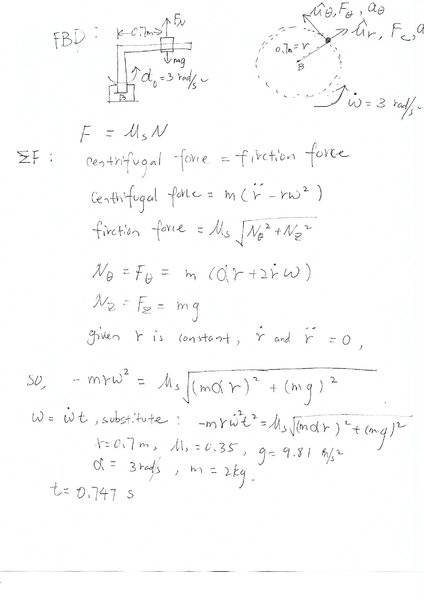

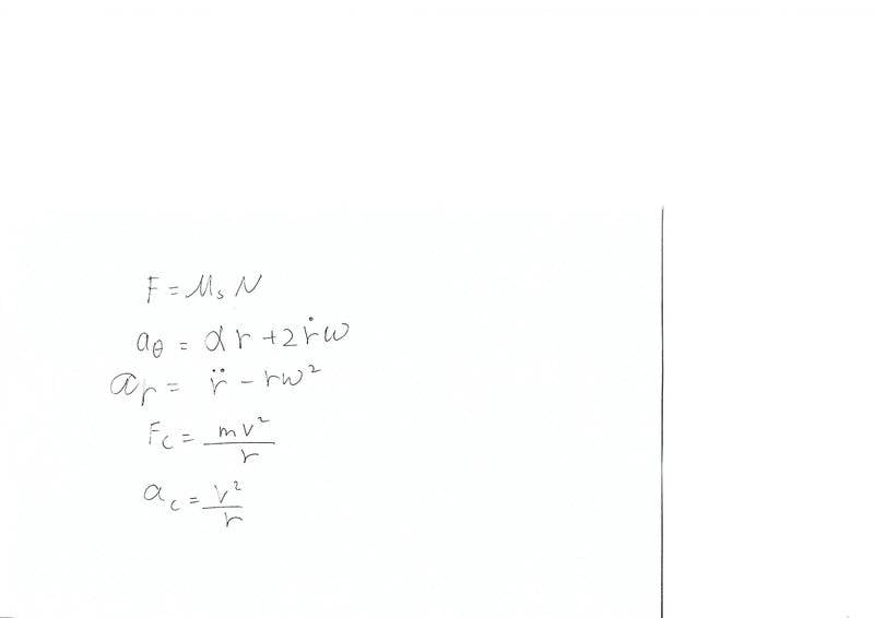

Hello everyone! I am studying for my final, and this problem is from the textbook.
here is my thought process when I tried to solve this problem:
rotating frame is an non-inertial reference frame, so i have to use centrifugal force instead of centripetal force. The only force that is going to make the mass to slip is the centrifugal force pointing in the direction of r, since the mass is a collar which it can only slip in the r direction.
Below is my attempt on this problem, its solved but i still have some questions. Initially, I thought the normal force in this case is just mg, i fixed it after checking with the solution, however, i still don't understand why force in theta direction would affect the normal force, to my knowledge, normal force is the sum of the forces in the vertical direction, but the force in the theta direction is perpendicular to the z axis, i am so confused.

so, pseudo force is the same force in the theta direction? I thought pseudo force is same as centrifugal force? or is he using the wrong term here? Please help~Heaven Bless You!
No. The normal force between two surfaces is the minimum magnitude action and reaction necssary to prevent interpenetration. One can deduce that it acts normally to the plane of contact, hence the term "normal".

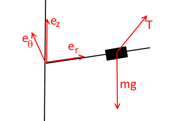

Here ##\boldsymbol T## is a reaction force. ##m\boldsymbol a=\boldsymbol T+m\boldsymbol g;\quad \boldsymbol a=-d\dot\theta^2\boldsymbol e_r+d\ddot\theta \boldsymbol e_\theta;\quad \ddot\theta=\alpha_0.##
Further ##\boldsymbol T=\boldsymbol T_n+T_{friction}\boldsymbol e_r,\quad \boldsymbol T_n=T_\theta\boldsymbol e_\theta+T_z\boldsymbol e_z;\quad |T_{friction}|=\mu_S|\boldsymbol T_n|##.
Thank you for helping me again! I see, so because its a collar on a bar, its different from the typical "a box on a ground" scenario, in such scenario, the normal force is just the sum of the forces in the vertical direction, but we have a collar here, so there are more than 2 directions where the forces can act, because the contacting surface is a cylinder.

oh my bad, I wasn't being careful, which frame of reference are you using? your equation ma= T+ mg, its a condensed form of summing the forces in 3 directions, correct? and Thank you for helping.
The equation ma=T+mg is written relative to an inertial frame. The collar experiences only two forces: the force T from the rod and the force mg from the Earth.
It is a one of the core concepts of Newton mechanics: forces show up from interactions between bodies. No bodies -- no forces.
Further we employ additional hypotheses about the force T. For example we break it into normal and tangent components and impose a relation between these two components. Another additional hypotheses are also possible but the equation ma=T+mg holds in any case.
