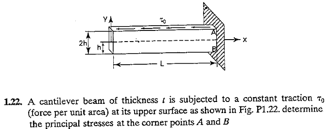

[tex]\sigma_x = -\frac{M(x)y}{I}[/tex]
[tex]I = \frac{bh^3}{3}[/tex]
For point A, I did the following:
[tex]I = \frac{t(2h)^3}{3}[/tex]
[tex]I = \frac{8th^3}{3}[/tex]
[tex]\sigma_x = -\frac{3\tau_0}{4th}[/tex]
[tex]\tau_{yx} = -\tau_0[/tex]
[tex]\sigma_y = 0[/tex]
Are my principal stresses correct for point A? Also, would these principal stresses be the same for Point B?
A principal stress state contains no shear. Also, it's hard to imagine why A and B would be equivalent when the applied traction is creating a moment around the fixed end of the beam.
