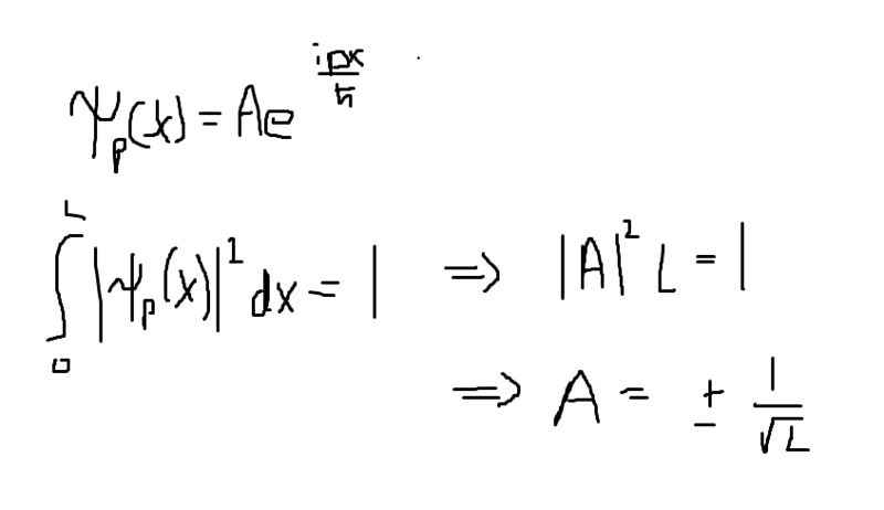

Hi, when normalising the wavefunction
I get two answers. Is this correct? My notes only has 1/sqrt(L) = A.
Normalization of wavefunction is always up to an overall phase factor ##e^{i\phi}##. You can always multiply by such a factor without affecting normalization so not only are there two possibilities, there us an infinite number of possibilities.
Edit: To be more explicit: The condition ##|A|^2 L = 1## is solved by any ##A## on the form
A = \frac{e^{i\phi}}{\sqrt L}
with ##\phi## an arbitrary real constant.

If ##\phi## is fixed, am I correct in saying that there are only two solutions in the form ##\frac{Be^{i\phi}}{\sqrt L}##, which is B = 1 and B = -1?
No. There are an infinite number of solutions, which correspond to shifting ##\phi##. Once you have the form ##e^{i\phi}## that is the general solution already. There is no point in introducing yet another multiplicative constant. Multiplying by ##-1## specifically just shifts the value of ##\phi## by ##\pi##.

I don't follow. By "shifting ##\phi##", you are changing the value of ##\phi##.
Yes, that's because ##\phi## is an arbitrary parameter that is not physically measurable. It can be set to ##\phi =0 \Rightarrow A=1## or ##\phi =\pi \Rightarrow A=-1## or to any other value whatsoever without changing the physical predictions that stem from the wavefunction. On the other hand, the phase difference between two quantum states is a physical observable.

I understand, but for a wavefunction of definite momentum, ##\phi=\frac{px}{\hbar}##.
Edit: Sorry if I am not making any sense, it seems like I have a misconception here which I don't see yet.
To help clarify, you guys are saying that if I have a -1/sqrt(L), it is equivalent to using the 1/sqrt(L) form given that I shift the angle ##\phi## by pi. I am fine with that.
But I claim that -1/sqrt(L) is acceptable without shifting the angle by pi.
No, that's not right. In the notation of your original post:$$\psi_{p}\left(x\right)=Ae^{ipx/\hbar}=\left|A\right|e^{i\phi}e^{ipx/\hbar}=\left|A\right|e^{i\left(px/\hbar+\phi\right)}$$So ##\phi## is the (arbitrary) constant phase of the complex normalization-constant ##A##, whereas ##px/\hbar## is the spatially-dependent phase of the complex wavefunction. Don't confuse your phases!

Thank you, that makes sense
This is wrong. Using -1 instead of 1 is changing the phase by ##\pi##. You could also use ##i##, ##-i## or any other phase shift (multiply by a complex number of norm 1).
Edit: The general solution to ##|B| = 1## is ##B = e^{i\phi}## with ##\phi \in \mathbb R## (or in ##[0,2\pi)## if you want to avoid duplicates). So the general solution is not ##A = \pm 1/\sqrt L##, it is ##A= e^{i\phi}/\sqrt L## with ##\phi## an arbitrary constant real number.
Yes sorry I misread your original comment, and thought that the angle was px/hbar, my bad! It makes sense now :) - I'm just used to seeing |A| only in real numbers, in which case then A is only +-A.

Is it standard in physics to omit this e^(iangle) term? As in the original post, it was just 1/sqrt(L).
If you just want a normalised wave function, you can pick any value for the angle. Choosing ##\phi = 0## is then perfectly permissible.
