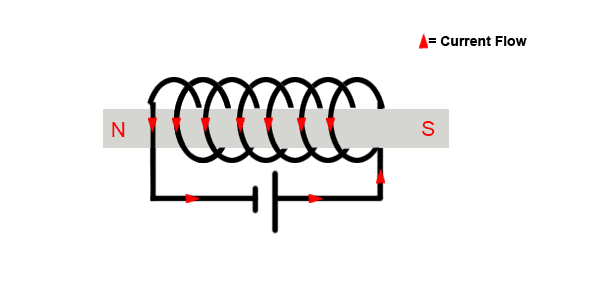

North and South of an electromagnetic solenoid
The poles of an electromagnet are determined by the direction of the current flow, as determined by the Right Hand Rule (RHR). In summary, the poles of an electromagnet are opposite of each other and are determined by the direction of the current flow using the RHR.

Explain the location of the poles of the electromagnet.
RHR
Is this correct?or are the poles opposite of what they are meant to be.
I believe it is south on the left a confirmation would be great thank you :)

You are right, it is south on the left and north on the right.
