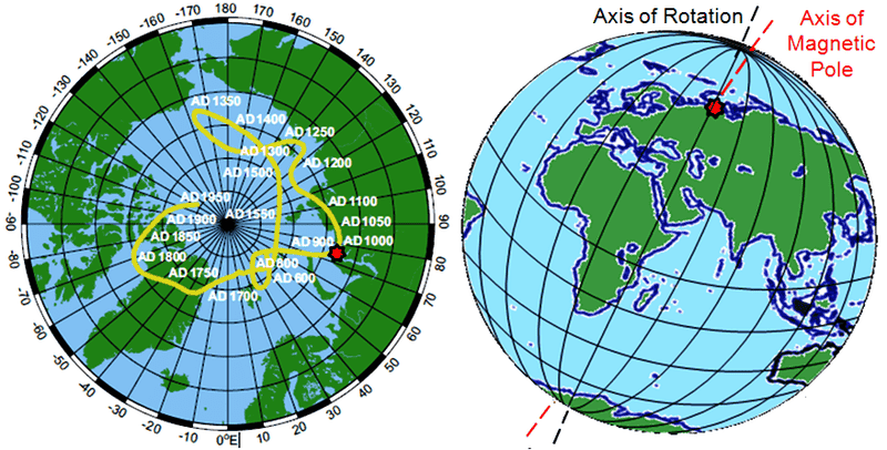

yeah but its wanderings over the last 1500 odd years is far more impressive ...
[ https://planet-earth-2017.com/wandering-poles/ ]

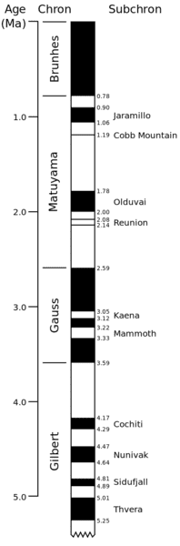

All I'm saying is that the effect of geomagnetic reversal on migratory bird species cannot be massive. We would see population crash patterns in the fossil record that matched the black and white graph below. The reason we do not see bird population crashes: bird navigation is multifaceted. Any species that relied totally on magnetic navigation would have been very strongly selected against, multifaceted navigators strongly selected for.
Points:
1. I am not aware of any paleontological data supporting catastrophic decline in bird populations or drastic speciation during the last pole flip.
If you have support for these declines, please let us know.
2. Pole wandering is apparently the norm, based on geological data. @davenn posted a link about a timeline of past "flip" events.
Here is another one, showing the past 5 million years and more than 20 reversals :
https://en.wikipedia.org/wiki/Geomagnetic_reversal
From the article ---
Black versus white: times during which geomagnetic polarity in black matches today's polarity, white is a reversal of that. Note some very thin black lines, short period events.
3. Bird navigation is based on one or multiples of the following:
per https://www.allaboutbirds.org/the-basics-migration-navigation/
Code:
visual -
    star maps for night migrating species
    imprinting
    landmarks and maps of them
    sun based
olfactory
   olfactory maps
magnetic
   magnetic field sensing
Please read the attached article.
Likes cbrtea2000, pinball1970, BillTre and 1 other person

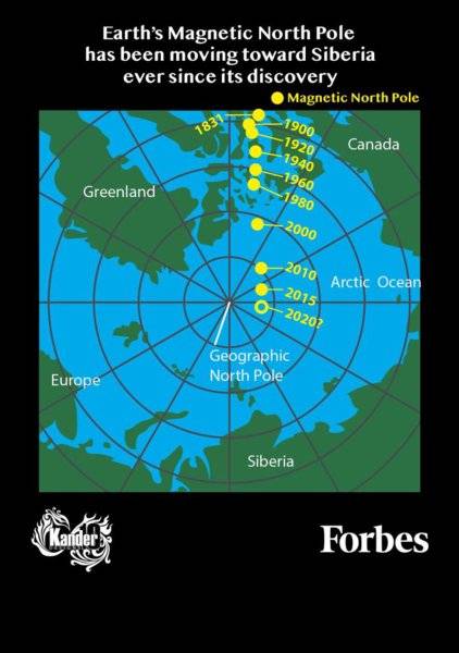

It is cruising. This is the first time that the WMM has required an out-of-cycle update (not supposed to exceed 1 deg. RMS over each five-year lifespan, and WMM2015 met 1.5 deg. RMS in March of 2018; updated in January of 2019). What I find especially odd, is the fact that the westward drift began accelerating near the year 2000--the same time that the rotation axis turned to the east (south), and UT1-UTC began slowing. https://datacenter.iers.org/singlePlot.php?plotname=FinalsAllIAU2000A-UT1-UTC-BULA&id=9

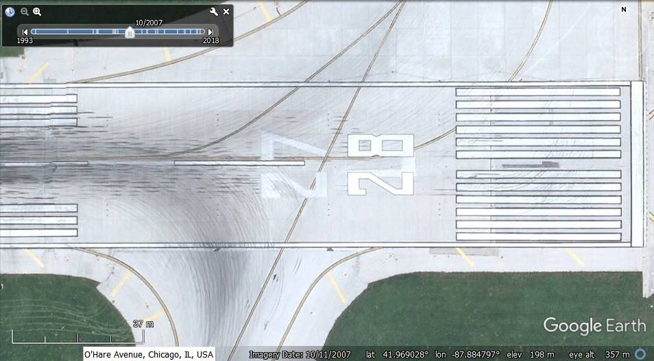

The number painted on the end of airport runways is the magnetic bearing in degrees, with the least significant digit removed. So to land on runway 27 you should be flying 270° magnetic, which is west on approach by magnetic compass.
Have any arctic airport runways needed to be renumbered yet ?

Yes. Generally speaking, the closer a runway is to the migrating N. magnetic pole, the greater the local magnetic variation will be at that runway location upon increased magnetic migration. Similarly, the further a runway location from the migrating N. magnetic pole, the less local magnetic variation those runways will experience. Consequently, runway renames are occurring pretty much everywhere--but especially in the Arctic.
  • Recently_renamed_runways.pdf
Likes cbrtea2000 and Baluncore

Here is the old 27 at O'Hare wearing out while it is replaced with the new 28.
