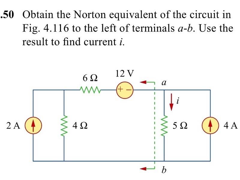

Obtain the norton equivalent of the circuit on terminals a-b. use the result to find the current i.
see attached image.
1.Shorting the terminal when finding norton
2. Open current source and short voltage source when finding norton resistance
By 2. We obtain
Rn = 6+4=10.
When Terminals a and b are short circuited we find current across it using nodal analysis
2+((12-v)/6)=v/4
v=9.6V

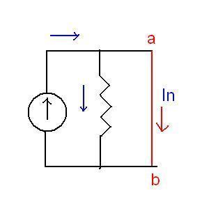

So that
In= (12-9.6)/6 =0.4A (current source facing upward)
This is the part where i am confused.
So connecting back the original components across terminal a-b (5 ohm and 4A in parallel) to the norton equivalent.
By current division We obtain
i = (10/(10+5))(4A + 0.4A) = 2.93A
The real answer is 2.4A , it's kinda odd because 0.4A norton current source is facing downward with this answer.
