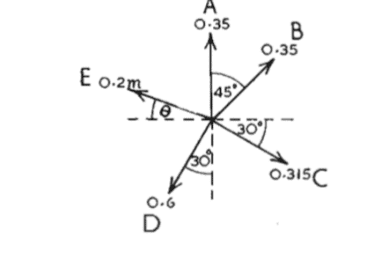

Not sure if I have the correct angle and mass for this sum of forces
In summary, the conversation discusses balancing forces east-west and north-south using the given equations and distances on a vertical plate mounted on a horizontal axis. The forces in consideration are the weights of the masses placed at specific distances from the origin. The conversation also addresses the possibility of balancing moments and questions the relevance of horizontal forces in this scenario. It is determined that only vertical forces are acting in this situation.
dougiehazard
Balance the following face plate if the masses are as follows:A = 2.8 kg, B = 3.5 kg, C = 4.2 kg, D = 4.8 kg, E = ?(What angle and mass should E be placed to balance the other 4 masses
Balance the forces east-west:
3.5kg*sin45º + 4.2kg*cos30º - 4.8kg*sin30º - E*cosΘ = 0
E*cosΘ = 3.712 kg
balance north-south:
2.8kg + 3.5kg*cos45º - 4.2kg*sin30º - 4.8kg*cos30º + E*sinΘ = 0
E*sinΘ = 0.982
EsinΘ / EcosΘ = 0.982 / 3.712
tanΘ = 0.2645
Θ = 14.8º ◄
E = 3.712kg / cos14.8º = 3.84 kg ◄
If that's not right, then you want to balance the moments.
balancing east west:
3.5kg*0.35*sin45º + 4.2kg*0.315*cos30º - 4.8kg*0.6*sin30º - E*0.2*cosΘ = 0
E*cosΘ = 2.86 kg
and north-south
2.8kg*0.35 + 3.5kg*0.35*cos45º - 4.2kg*0.315*sin30º - 4.8kg*0.6*cos30º + E*0.2*sinΘ = 0
E*sinΘ = 6.55 kg
EsinΘ / EcosΘ = 6.55 / 2.86
tanΘ = 1.706
Θ = 59.6º ≈ 60º
E = 6.55kg / sin59.6º = 7.6 kg
I assume you are asking which approach is correct.
Are we to understand that the plate is mounted vertically on a horizontal axis through the origin, and that the numbers in the diagram are distances of the masses from the origin?
What forces act where?
forces are the weight id assume and yes the number are distances in the diagram
Then why are you considering a horizontal balance of forces?
Does any other force act vertically?
