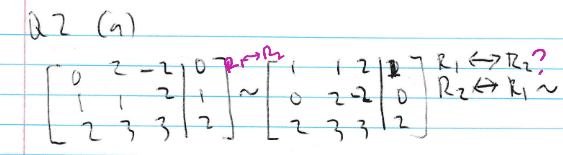

Please see below
Please see below
For this,
What was wrong with the notation I used for showing that I has swapped the rows? The marker put a purple ?
Any help greatly appreciated!
Many thanks!
I would interpret R1 <-> R2 to mean swap row 1 and row 2. But then you put R2 <-> R1, so that would swap them back where they started.
The note that your teacher put there is a little troublesome.
I would use right-pointing arrows, R1 -> R2 to indicate that row 1 goes to row 2. But then does it overwrite row 2? It's a little ambiguous.
I would prefer one of these two approaches:
1) A single R1 <-> R2.
CORRECTION: There is a level of standardization of the notation that I was not aware of. This option #2 is wrong.
2) R1 -> R2' and R2 -> R1'

Thank you for you reply @FactChecker!
Your approaches are very helpful. The course textbook uses the first which I think I will use.

Why are you inventing your own notation? There is a universally recognised notation for elementary row operations, in this case R1 <-> R2 (or rather ## R1 \leftrightarrow R2 ##).

I read it as a wrong positioning. I think it should have been
A\stackrel{R_1\leftrightarrow R_2}{\sim} B
and not
\left. A\sim B \right| R_1\leftrightarrow R_2\, , \,R_2\leftrightarrow R_1
which is too late, since you already did it at ##\sim##, and ambiguous since you seem to do and re-do it.
As already mentioned, I believe the note was that your notation appeared after the 2nd matrix, not between the 1st and 2nd matrices.

As already mentioned by @pbuk, the standard notation for swapping rows m and n is ##R_m \leftrightarrow R_n##. There are only three row operations:
  1. Exchanging (swapping) two rows: ##R_m \leftrightarrow R_n##
  2. Replacing a row by a nonzero multiple of itself: ##R_m \leftarrow kR_m##
  3. Replacing a row by the sum of another row and itself: ##R_m \leftarrow R_m + R_n##

Ok, I'll buy that. I didn't know that the notation was so standardized.

This is interesting. Although it makes sense, I didn't realize that there was so much standardization here. So the notation: ##R1 \leftrightarrow R2, R1 \leftrightarrow R3## is not commutative. The second ##R1## is the original row ##R2##.
This type of standardization is significant when a mathematical notation of row operations is developed. It is intellectually satisfying. :-)
