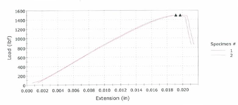

I think the situation I am talking about is bit more complicated than that. I was able to dig up the plot that I was referring to:
The material is Titanium 6Al-4V STA and the rod has a nominal diameter of 0.163". The minimum diameter at the center of the notch is 0.079".
Using the minimum area at the notch (and not considering any notch strengthening effects), I would expect the rod to fail in tension around 833 lbf (170 ksi * pi/4 * .079"^2). Without the notch, the rod should fail around 3500 lbf. However, we see that the bolt actually fails at 1500 lbf. Not considering any reduction of area due to necking, that gives a maximum stress of around 309 ksi, 1.8x the specified tensile strength of the member.
Even if we consider true stress, we would expect the member to fail at a even lower force (<833 lbf) because of the slight reduction of area during the deformation (i.e. higher stress).
Looking at the Matweb data, there is a "Notched Tensile Strength" of 225 ksi (Kt = 6.7), which tells me there is some sort of notch strengthening effect going on.
Does that make more sense?
The surface of a rod will have scratches that form the start of cracks leading to tensile failure. I suspect that the notch radius and surface finish of the notch is better than the natural surface of the rod. The neck moves surface forces into the body of the rod, away from the unreliable chilled surface. That prevents excessive stress concentration at the end of surface cracks.
There is a parallel technique I have seen used on truck axles. Long ago I was told that by machining a rounded notch close to the spline, after breaking an axle at the notch, the spline can be more easily pulled from the differential and the axle replaced without dismantling the entire assembly. Also, that if the rounded notch is cut, the axle is less likely to break because of Murphy's Law. Now I see that it may not be Murphy's Law, (human perception bias), but “notch strengthening” that is having the paradoxical effect.

Thanks for the graph and calculations. Very interesting how the load is affected.
The reason I did say it was probably more complicated, is that the usual graphs one sees for stress-strain take into account only the one dimension, using only the axial load ( which one knows ) and the area of the specimen ( which one knows ). For machine design that should be adequate in a majority of cases, and one does not have to go further in stress analysis.
In fact, though, a small element dx,dy,dz of the material is never under just one single stress. On each face, there could be an axial load and shear ( in each direction by the way ). You will notice that moving out from an element located at the centerline of the specimen, all elements are bounded by another element, except the one at the surface.
If I recall correctly ( which maybe I do not ), the outmost elements first experience plastic deformation, which then extends into the specimen as the load continues. For the specimen to change volume, an element, call it A, has to move from its original location to another location. But, as there is another element in the way, A can thus have a tensile or compressive stress on its other faces orthoginal to the axial load. With compression this might be easier to see, as for as element A attempts to "squish" out of its original loacation due to the stress on its axial face, it is bounded by an inner element that is also pushing it outwards radially and by an outer element that is pushing it inwards. In the tangential direction the same stresses are occurring.
For the notched ductile specimen, the notch would want to deform plastically, but being bound by the main part of the speciment, which is still elastic, it can't.
Hope that makes some sense.
