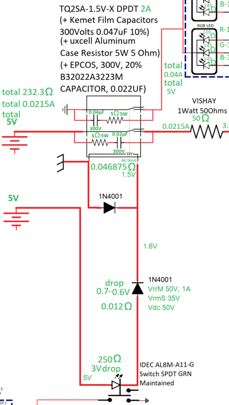

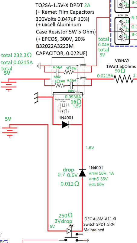

Hello,
In regards to this relay, TQ2SA-1.5V Panasonic 2 Form C AS Single side stable, 1.5VDC 2A DPDT NON-LATCHING SMD Relay
https://www.mouser.com/ProductDetail/769-TQ2SA-1.5V
PDF 1 of Relay
PDF 2 of Relay (specifically pages 5-6) is attached at the bottom as a pdf file.
I was previously told that I would need to wire a IN4001 diode which have a 50VDC blocking capacity, in parallel to the coil pins of this relay which could produce a back emf surge of up to 50VDC, which was more than enough to protect this specific circuit.
https://www.engineersgarage.com/electronic-components/1n4001-diode
PDF of 1N4001-Diode
I know basic electronics and ohms law theory, but I'm still a bit of a novice to when it comes with electronics, but is this true? Is a IN4001 diode more than enough to protect this circuit?

but I'm not sure how to translate this as useful data when looking at the capacities of the IN4001 diode.I was also told that I needed to protect the contact ends of the relay since when they open up, they tend to create an arc that can wear out and damage the relay's performance. I was reading on another forum that in order to minimize this damage that I needed to wire a capacitor and a resistor in parallel to those contact ends, which they provided a "No Math" approach to figuring out the capacity and type of capacitors and resistors that I needed, which was the following method,
for the farad value of the capacitor,
0.5 to 1 µF per switching current (or per 1 Amp)
and for the voltage of the capacitor,
Use a capacitor with a dielectric strength between 200 and 300 V
and for the resistance value of the Resistor,
0.5 to 1 O per switching voltage (or per 1 Volt)
Based on my schematics, are 0.04µF 300VDC capacitor + 5 Ohm 5 Watt resistor approprate for a circuit that has total of 22mA and 5VDC, and a 0.02µF 300VDC capacitor + 5 Ohm 5 Watt resistor for a circuit that has total of 40mA and 5VDC?
Sorry for asking a beginner's question, but I'm still trying to learn more about circuitry and electrical engineering. Thank you for your time!

Serious case of overdesign. Those 5W resistors will be bigger than the relay, you know :smile:
For the coil, that 1N4001 is more than enough. The back EMF is generated by the coil of the relay, its size/energy depends on the coil size and its polarity is in reverse than the original polarity of the current. So during a back-emf situation that diode will face it with the forward voltage, which is ~ 0.6V for most basic diodes anyway. If there would be significant energy then bigger diode would be needed due the current, not the voltage... The reverse voltage capacity of 50V matters only against the battery there. 50V vs. 1.5V - more than enough.
About the breakdown voltage: that means that the coil and the contacts are safely insulated to each other up to that voltage. Directly not related to sparks or arcs.
Regarding the arcs on the contacts: actually, how long lifetime are you aiming for? That design approach would be adequate to make those contacts last till the Coming of the Horsemen :oldbiggrin:
For this low load those contacts will be fine without any protection at all, unless you have significant inductance in the switched circuit.
If you want to stick with the cap&resistor, then the most simple SMD would be more than enough. At least that won't cost more than the relay... Also, the voltage of the cap is good at 25-50V: any common ceramic SMD will do.
Ps.: just noticed that you plan to use a LED to provide the necessary voltage drop between the relay and the battery? That's not a good idea, battery voltage does not count as constant. You might get that LED burned if the battery is full, while it just won't work when the battery is low.

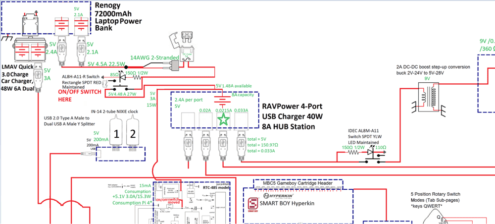

Ahahaha 😅 the entire circuit of the led button that controls the relay isn't directly connected to the battery (which is a portable charger; although there's another led button switch that is, that is connected in parallel with the switch that controls almost the entire device I'm building by acting as an on and off switch), that specific led button that controls the relay gets its power from a usb hub port that provides at most 2.4amps (which through my estimations, it seems only one and a half amp will be available to that hub) and I believe that hub has smart current limiting technology, but I'm not really positive on that, I have to double check since I'm still touching up on some areas in this total project.
in the schematics, the usb port that has a star is where the led switch and relay get their power from. But about current draws, although a battery or power source may provide more amperage than is required for a specific circuit, doesn't the resistance from the devices and the voltage of the circuit limits current draw on their own? Or in other words, that circuits and the devices will only draw on the current that they need despite what the battery provides? (and if this was the case, would that damage batteries since they are designed to drain at an appropriate rate?) Or is the amperage that the battery or power source provides forced onto the entire circuit which will wear out the entire circuit at a faster rate?

With a battery you have to design for the maximal and the minimal voltage too, not just for the nominal (for a 12V lead-acid battery, it is 14V, 12V, 9V... Quite a range). And in case of LEDs it is important, since those are not linear with V and A. Slight change in voltage might cook the thing.
Just one more small remark on the USB charger. These are chargers: things are not necessarily expected to actually work when connected. You better check the output voltage and noise.
