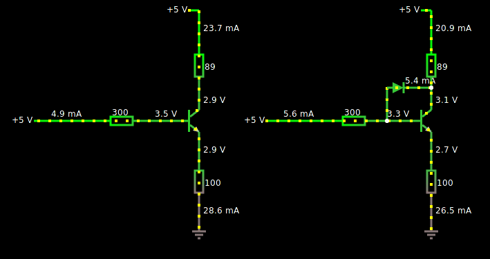

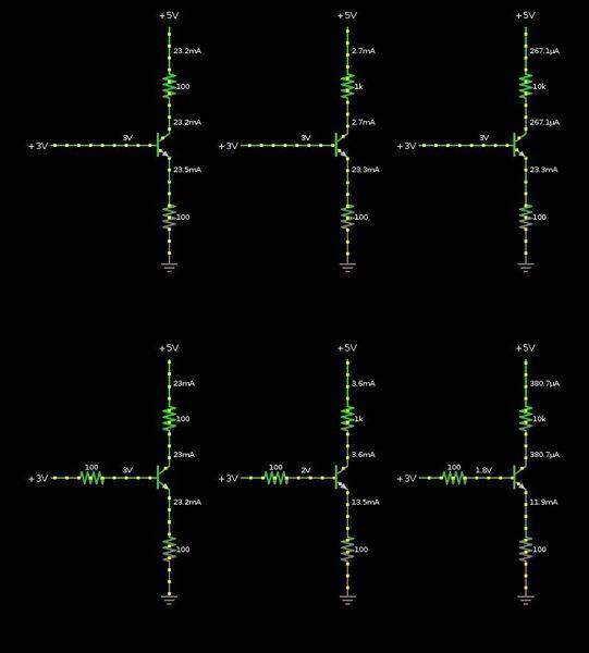

I don't know how to calculate the voltages at the bases of every transistor shown in the lower row of that picture (~3V (2.9..V), ~2V, ~1.8V). Any help would be appreciated! - I'm currently trying to figure that out...
Screenshot_2016-07-08_22-12-56.jpe

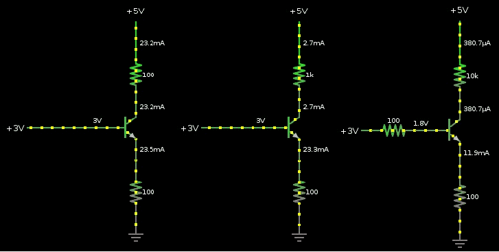

The other thing I don't really understand: Why do the transistors in the upper row all have an equal emitter current? Does the the collector-emitter current really only depend on the base current (Ice = Ib * hfe), and not on what's in front of the collector (100 Ohm, 1 kOhm, 10 kOhm)? And why can transistors do this?
(I'm currently trying to learn more about the absolute basics in electronics. - The used simulation tool can be found here. The goal is to understand things like current mirrors and differential amplifiers... but I don't even really get how a simple transistor (BJT) works. Oh well.)
In the upper row you keep the base voltage constant at +3V. This means that the emitter voltage must be Vbe below +3V or about 2.3V. 2.3V divided by 100Ω (Re) equals 23mA.
In the lower row, the base is not kept at a constant voltage, but at +3V - Rb⋅Ib. Now, Ib depends on Ic and the current gain of the transistor - and Ie = Ic+Ib...
Likes 1rel
Keep in mind that the transistor acts as a voltage-controlled current source (Vbe controls Ic).
This is in accordance with the well-known Shockley-equation: Ic=Is*exp(Vbe/Vt -1) with Vt=temperature voltage (app. 26mV at room temp). The base current Ib is always a small (fixed) portion of the collector current Ib=Ic/B.
That means: It does not matter if the collector resistor Rc is 1k or 10k - the transistor always produces the same current Ic.
However, this applies only as long as the transistor is operated within its active region.
That means: The collector-emitter voltage Vce must not fall below app. 1V.
Otherwise, the transistor is not operated anymore within its "linear" region - and the relationship Ib=Ic/B does not apply.
Therefore: To understand the voltages and currents in the given examples, I recommend to recalculate the various voltages Vce across the transistor. This can be done simply by applying Ohms law for the the collector as well as emitter resistors.
(Note: The above description is the idealized case; in reality, there is a small dependence on Rc resp. Vce because the transistor is, of course, not an IDEAL current source. But this effect is not considered in all transistor models).
Likes 1rel
Yes, that makes sense!
At the 3 configurations in the top row:
Assuming that the transistor is in its "active region" or even more so in saturation, the collector-emitter voltage drop is small, and the collector-emitter path can be regarded to be a short circuit (right?). So, I can apply Ohm's Law to calculate the currents through the Rc resistors:
(Vcc = 5V and Ve = 5 V - 2.3 V = 2.7 V):
For Rc = 1 kΩ : Ic = ( Vcc - Ve ) / Rc = 2.7 V / 1 kΩ = 2.7 mA
For Rc = 10 kΩ: Ic = ( Vcc - Ve ) / Rc = 2.7 V / 10 kΩ = 270 μA
This seems to coincide with the values shown in the simulation...
But when the transistor is at the edge of becoming active (low base current?), it has a higher resistance on the collector-emitter path and the calcs above don't work anymore.
The simulation shows a collector current Ic of 23.2 mA. So the Rec of the transistor could be calculated like this I guess:
For Rc = 100 Ω and given Ic = 23.2 mA (sim):
Vc = Vcc - Ic⋅Re ) = 5 V - 23.2 mA ⋅ 100 Ω = 2.68 V
(((Rce = Vc / Ic = 2.68 V / 23.2 mA ≈ 116 Ω)))
EDIT: Rce = Vc / Ic - Re = 2.68 V / 23.2 mA - 100 Ω ≈ 16 Ω
Yes, but I don't really get that yet. I'm trying to figure out how to calculate these values first on paper first, and later hopefully understand the transistor model more intuitively... Probably I build this up on the bread board today.
BTW: The current gain of the simulation transistor model is fixed at 100, which makes it easier to understand the numbers. BTW, here is the simulation file used, now correctly linked (geat simulator by the way with lots of instructive examples)
More later...
1rel, regarding the lower row:
When the transistor is in its active region (lower row, most left circuit), what is the voltage drop across the base resistor caused by the base current (when the current gain is 100)? Is there any severe difference when compared with the most left circuit in the upper row?
Likes 1rel

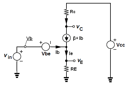

Things I can write down after looking at the circuit in the lower row, and convert it to the "linear mode" replacement circuit (see above), I can write down those things about it:
(1) VIN = RB ⋅ IB + VBE + RE ⋅ IE
(2) IC = β ⋅ IB
(3) IE = IC + IB = IB ⋅ (1+β)
(4) VCC = VRC + VCE + VRE
(5) VRC = RC ⋅ IC
(6) VRB = RB ⋅ IB
(7) VRE = RE ⋅ IE
(8) VC = VCC - VRC
(9) VB = VIN - VRB
(10) VE = VB - VBE
(11) VCE = VC - VE
(12) VBE = 0.65 V
(13) β = 100
(14) VIN =3 V
(15) VCC = 5 VIB = ( VIN - VBE ) / ( RB + RE * ( 1 + β ))
VCE = ( VCC - IB * ( 1 + β ) * RC ) - RC * β * IB
VB = VIN - RB ⋅ IB
IC = β ⋅ IB
VC = VCC - RC * IC
VE = VB - VBE
IE = IC + IB
VCE_check = VC - VEAnd get:
RC = 100 Ω, RB = 100 Ω, RE = 100 Ω (lower row, left)
VCE ≈ 0.369 V > 0.2 V
IB ≈ 230 μA > 0.0 A
IC ≈ 23.0 mA
IE ≈ 23.3 mA
VC ≈ 2.70 V
VB ≈ 2.98 V
VE ≈ 2.33 V
That seems to be about equal to the values in the simulation.

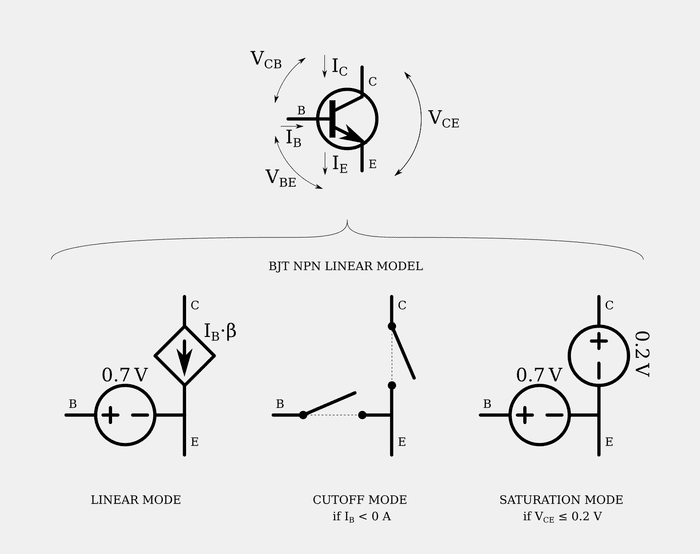

In saturation mode (VCE values below threshold) you must not use the beta-values (100). These values are valid for the active amplification mode only.

Right, I'm taking that crude linear model, and replaced the collector-emitter path by this 0.2 V voltage source (just a constant drop of 0.2 V). However, this is all a bit abstract to me...

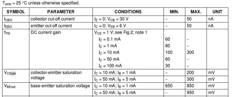

In saturation mode (VCE values below threshold) ...

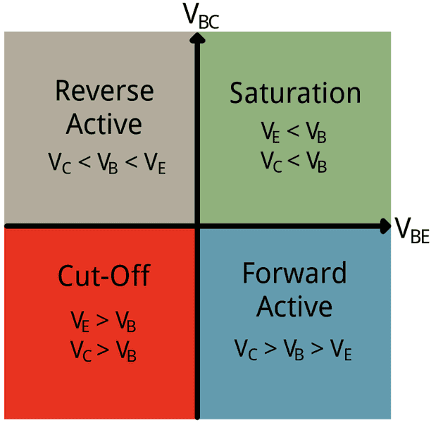

So there are some conditions that say that the NPN BJT is in saturation mode... VCE <= 0.2 V (simplified "linear model" above). And as it seems, it can also be simplified this way:
According to this chart, the example above should be in saturation mode as well: VB > VC > VE
VC ≈ 2.70 V
VB ≈ 2.98 V
VE ≈ 2.33 V
But I calculated the numbers with the "linear model" replacement circuit from above (VCE ≈ 0.369 V > 0.2 V). So, the transistor's operation point is somewhere at the border between saturation and active region I guess... at least it worked.

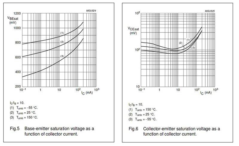

When I look into the http://www.nxp.com/documents/data_sheet/MMBT3904.pdf... I see those saturation parameters, and it still puzzles me... What's really going on there, how should a simplify this? Is the rule of thumb VB > VC > VE really valid to say, that the transistor is in saturation mode?

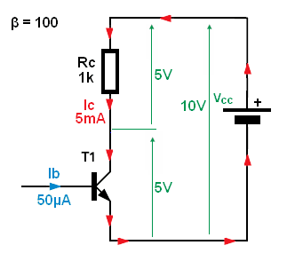

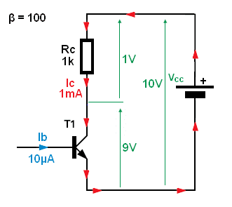

1rel said:
That can be verified in the two simulation examples above. What's still surprising me, is that the emitter current in both examples is also the same! - It kind of makes sense, because the voltage across the 100 Ω load resistor is always the same (VE = VB - 0.7 V), therefore the current must be VE / RLOAD. However, the current on the left (without a collector resistor) is coming from collector, which is always at +10V. But on the right (with a 10k collector resistor), it is mainly coming from the base of the transistor (IB >> IC)! I still don't get that...
For the most right circuit, the 10v supply does not matter because the voltage drop across the 10k resistor is so large that the collector voltage is only a liitle larger than the emitter voltage. Hence, the charged carriers in the base region are not accelerated by a large collector voltage (forming a large collector current). As a consequence, the only remarkable current is between B and E.
Final comment (recommendation): Do not put too much information into one contribution and do not ask too much - this may keep some forum members from reading all this stuff (information and questions).

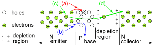

One final answer:
1rel said:
Any hints would be appreciated. I have a hard time understanding those BJTs... it would be really nice to have a simple trick to understand them more easily...

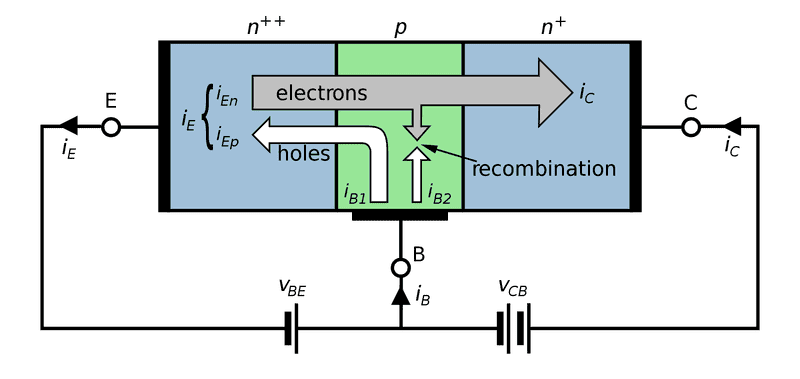

There is no "trick" at all. Everything can be explained /described with physical relationships (example npn).:
(1) A base-emitter voltage of app. +0.7V releases electrons from the emitter moving to the base region. Here, they "feel" thath the p-doped region contains only a few electrons - and the electrons start to diffuse into the p-region ("diffusion pressure").
(2) Caused by a collector potential (at least some volts higher than the base potential) there is an electrical field which further accelerates the electrons in the direction to the collector. Thus, they have enough energy to cross the very small base region and reach the collector (forming the collector current). Only a very few move to the base node (forming the base current).
(3) This is a somewhat simplified description of the transistor principle. Note that it is the base-emitter VOLTAGE that determines the amount of electrons leaving the emitter region (emitter current). When 99 % arrive at the collector we have a ratio B=Ic/Ib=99.
Likes Svein and 1rel

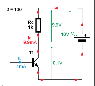

Exactly! The base current cannot do anything about the collector current, when there's not a high enough voltage to make the charged carriers flow. The transistor is saturated (because of the large collector resistor), and VCE is really small, so the collector-emitter path is basically shorted... both -- base-emitter and base-collector junctions -- are forward biased, and VB ≥ VC > VE. And IC << β * IB. And in this case, the base current is larger than the collector current, because of the large collector resistor.
There's a physical limit for the amount of base current that can flow, compared to collector current, which is smaller than the max collector current I guess?
Looking it up quickly, revealed that the the physical size of the base is not really the limiting factor here *guessing*.
Ah, it's great to look more closely into the physical construction of those semiconductors, instead of those abstract models. The physical charge carriers (electrons/"holes") that move through that tiny n-/p-doped semiconductor...
(1) This behaves about the same like the p-n-junction in a diode. When the 0.6-0.7 V threshold is surpassed, the electrons flow from the n-doped (cathode) silicon to the p-doped (anode).
(2) The electrons that come from the emitter recombine with a few holes coming from the base, but pass through to the collector that is attracting them by a higher voltage (compared to emitter/base - in active mode).
(3) Simplified is good, as long as it helps understanding... β is the ratio of charge carriers/current entering the base versus entering the collector (β = 100: for every electron entering into the base, 100 go to the collector. - The same is also true in reverse, when using conventional current flow... for every charge carrier leaving the base, ...).

Hi, let me try to show you how you can use current controlled current source model of the BJT.
And the circuit is
At first let we need assume some values. Vbe = 0.6V; β = 100; and Vce(sat) = 0.2V; Vin =3V ; Vcc = 5V;
Now we can apply a KVL for the first circuit
Vin = Vbe + Ie*Re (1)
Ie = (Vin - Vbe)/Re = (3V - 0.6V)/100Ω = 24mA
and Ic = β/(β+1)*Ie = 100/101*24mA = 23.76mA
Ve = Ie*Re = 24mA*100Ω = 2.4V
Vc = Vcc - Ic*Rc = 5V - 23.76mA *100Ω = 2.624V
Vce = Vc - Ve = 2.624V - 2.4V = 0.224V
Transistor is on the edge of a saturation region
Now case (2) Rc = 1kΩ
Ie is still equal to 24mA but now
Vc = Vcc - Ic*Rc = 5V - 23.76mA*1kΩ = -18.76V WOW.
Negative voltage at collector is impossible if your voltage source is 5V the lowest voltage you can get is 0V. Transistor cannot create any voltage. Transistor is not a source of a voltage. Also one of the things that get people super confused is the presumption that the base current is being magnified to form the collector current. But this is not true. What is happening is that the base current is controlling the amount of current that Vcc supplies (sorry LvW I know that you do not like "base current version"). Just like a water tap.
http://obrazki.elektroda.pl/7783290500_1468689739.gif
And this mean (negative voltage on collector) that BJT is in saturation region.
https://www.physicsforums.com/threa...-gain-in-saturation-mode.865392/#post-5432159
And in saturation Ic = Ib*β do not hold any more. The only thing we ca do now is to apply only KCL (Ie = Ib + Ic) and assume Vce(sat) value.
So we have
Ie = 24mA and Ve = 2.4V
Ic = (Vcc - (Vce(sat) + Ve))/Rc = (5V - (0.2+2.4V))/1kΩ = 2.4mA
and Ib = Ie - Ic = 24mA - 2.4mA = 21.6mA
And the last circuit with Rb = 100Ω ; Re = 100Ω; Rc = 10kΩ
Vin = Ib*Rb + Vbe + Ie*Re
Ie = Ib + Ic = Ib + Ib*β = Ib*(β + 1) or Ib = Ie/(β + 1)
Therefore
Vin = Ie/(β + 1)*Rb + Vbe + Ie*Re
Ie = (Vin - Vbe)/( Rb/(β +1 ) + Re ) = (3V - 0.6V)/( 100Ω/101 + 100Ω ) = 23.76mA
Ve = 2.376V
And Vc = Vcc - Ic*Rc = 5V - 100/101*23.76mA * 10kΩ = -230.2V well, what a surprise the BJT is in saturation region.
And because Ic = Ib*β do not hole any more we are force to use Ie = Ib + Ic and Vce(sat) = 0.2V.
Ie = Ib + Ic (1)
Ie = Ve/Re = Ve/100Ω (2)
Ib = (Vin - (Vbe + Ve) )/Rb = ( 3V - (0.6V + Ve) )/100Ω (3)
Ic = (Vcc - (Vce(sat) + Ve )/Rc = (5V - (0.2V + Ve) )/10kΩ (4)
Ve/100Ω = ( 3V - (0.6V + Ve) )/100Ω + (5V - (0.2V + Ve) )/10kΩ ---> solve for Ve
Ve = [ (Vin - Vbe)/Rb + (Vcc-Vce(sat))/Rc ]*(Rg||Rc||Re) = [ (3V - 0.6V)/100Ω + (5V - 0.2V)/10kΩ ] * 100Ω||10kΩ||100Ω = 24.48mA *49.75Ω = 1.217V
so we have
Ie ≈ 1.21V/100Ω = 12mA
Ic ≈(5V - (0.2V+1.21V))/10kΩ = 359μA
Ib ≈ Ie - Ic ≈ 11.6mA

With my limited understanding of the subject, I would still agree. The base-emitter voltage VBE, i.e. the actual electrical field inside the transistor between those terminals, is the physical cause of the base current IB, that controls the collector current IC.
A high enough voltage VBE forward biases the P-N junction diode consisting of base and emitter, and let's electrons move from the emitter (N type material in NPN case) over to the base (P type), so that the depletion region (or space charge region!) between those materials is overcome, broken down. Charge carriers (electrons/holes can flow).
Looking at that alone doesn't explain yet why the current can also flow through the emitter-collector path, because the base-emitter P-N junction diode is reverse biased (VB < VC, in active mode). Hm.
Looking it up on Wikipedia revealed some important "details", that I still have difficulties with to really get:
In typical operation, the base–emitter junction is forward biased, which means that the p-doped side of the junction is at a more positive potential than the n-doped side, and the base–collector junction is reverse biased. In an NPN transistor, when positive bias is applied to the base–emitter junction, the equilibrium is disturbed between the thermally generated carriers and the repelling electric field of the n-doped emitter depletion region. This allows thermally excited electrons to inject from the emitter into the base region. These electrons diffuse through the base from the region of high concentration near the emitter towards the region of low concentration near the collector. The electrons in the base are called minority carriers because the base is doped p-type, which makes holes the majority carrier in the base.
To minimize the percentage of carriers that recombine before reaching the collector–base junction, the transistor's base region must be thin enough that carriers can diffuse across it in much less time than the semiconductor's minority carrier lifetime. In particular, the thickness of the base must be much less than the diffusion length of the electrons. The collector–base junction is reverse-biased, and so little electron injection occurs from the collector to the base, but electrons that diffuse through the base towards the collector are swept into the collector by the electric field in the depletion region of the collector–base junction. The thin shared base and asymmetric collector–emitter doping are what differentiates a bipolar transistor from two separate and oppositely biased diodes connected in series.
So the charges that enter the base (where they are always minority carriers - electrons in the NPN case, holes in PNP), recombine with the charges coming from the base terminal, recombine there, and somehow also move over the depletion region to the collector... Although that junction is reverse biased. I don't really get that yet.../// sidenote alert ///
Hi Jony130, it took some time to go through your calculations - and I can agree to everything.
However, I have one question:
* Why do you think that you have used the "current controlled current source model of the BJT" ?
For my opinion, you have used all the equations everybody will use (including, of course, Ic=B*Ib).
However, does this mean that you have used a "current-control model"? At which step of the calculation?
* On the other hand, you have used - as an initial assumption - a value of Vbe=0.6 volts. That`s OK.
But are you aware what this means? You need such a voltage to open the transistor - otherwise there will be no current at all!
And if you use 0.7V instead of 0.6V the emitter current will be Ie=(3-0.7)/100=23mA (instead of 24mA).
Where do you see any influence of the base current, which even is not yet calculated ?
Neither the base current nor the factor B were used for finding this value of Ie. Only Vbe !
(Hint for newcomers: Here we see the important influence of an emitter resistor Re: The uncertain assumption of a Vbe voltage - 0.6...0.7V - will have only minor influence on the actual Ie value. Without such a resistor we would face a dramatic and very sensitive dependency between Vbe and Ie, see Shockleys equation).

Jony130: That was of great help understanding the initial example! Thanks a lot for the examples, those will come in handy in many situations!
Ie = Ib + Ic (1)
so we have
I was able to follow until the last example (RC = 10 kΩ).
That's where I got stuck...
100Ω||10kΩ||100Ω
That means those 3 resistors in parallel, right? Rtot = 1 / ( 2/100Ω + 1/10000Ω ) ≈ 49.8 Ω
In sage gives almost the same result:
Code:
e = 100
Rb = 100
Rc = 10000
Vin = 3
Vcc = 5
Vbe = 0.6
Vcesat = 0.2
vars = var('Ic_, Ie_, Ib_, Ve_')
eq1 = Ie_ == Ib_+ Ic_
eq2 = Ie_ == Ve_  / Re
eq3 = Ib_ == ( Vin - ( Vbe + Ve_ ) ) / Rb
eq4 = Ic_ == ( Vcc - ( Vcesat + Ve_ ) ) / Rc
equs = [ eq1, eq2, eq3, eq4 ]
sol_n = solve( equs, vars, solution_dict=true )
#sol_x = solve( equs, vars ); sol_x
sol_n[0][Ie_].n(50)
sol_n[0][Ic_].n(50)
sol_n[0][Ib_].n(50)
[[Ic_ == (3/8375), Ie_ == (102/8375), Ib_ == (99/8375), Ve_ == (408/335)]]
0.012179104477612
0.00035820895522388
0.011820895522388
I want to come back solving that by hand later on...

LvW: @graph
Aside from the CCVS-VS-CCCS discussion (which I cannot really contribute to), the operating points graph in the PDF, showing IE as a function of VBE of the transistor's base-emitter P-N junction. It looks indeed like a normal I-V graph of a diode! And the linear IE work-/loadline describes the emitter current through the emitter resistor depending on VBE (?)... actual current can be determined by crossing the two functions, each crossing shows the actual base current (non-linear), at a certain base-emitter voltage... - All new to me, those load line concepts, but they seems to be really useful for understanding/visualizing the actual behavior, to build a mental model that helps analyzing/build circuits more intuitively.@physical model:
I've found a really good explanation of the physics of the BJT there:
http://www.allaboutcircuits.com/textbook/semiconductors/chpt-2/bipolar-junction-transistors/
The answer to the earlier question about the conducting reverse-biased base-collector junction seems to be, that the P-N junction in the NPN BJT in active mode is conducting, because the electrons actually get into the depletion region of the P-N junction between base and collector. The base is really thin! So most of the electrons (minority carriers in the base) flow from the P material (lots of holes) of the base to the N-doped silicon of the large collector, because there's an electric potential/field in the depletion region that makes the surplus of electrons in the base jump over to the N-doped collector, where they can flow out through the collector terminal. How many per second? That depends on VBE and VCE. IB only makes sure that the depletion layer between base and emitter is "broken down", i.e. the junction is forward biased, thus "weakend", so that current can pass (0.6-0.7 V). How much electron current can flow from the emitter to the base (NPN) depends on VBE, like in a diode (?) (edit: not sure about this...).
1rel said:
LvW: @graph
Just a small correction: Emitter current (instead of base current).
Why? And where ?
Yes, R1||R2 ----> parallel-----> 1/(1/R1 +1/R2)
And the Ve equation for case 3
[tex]V_E\ =\ \left(\frac{Vin-Vbe}{R_B}+ \frac{Vcc - Vce(sat)}{R_C}\right)* R_B||R_E||R_C [/tex]

Hey Jony - this can be explained very easily: It is not necessary to include the transconductance gm in the data sheet because it is a physical quantity which does NOT depend on the transistor type. It is a parameter that depends on the chosen quiescent current only!
Remember: Transconductance gm=Ic/Vt is the SLOPE of Shockleys equation Ic=f(Vbe).
(Ohms law does also not appear in data sheets).
And this is why, when we are looking into the BJT from the outside world perspective (we do not care about internal behaviour) we see "current-control" device (low input impedance,
This I do not understand. This is nothing else than an assertion, is it not?
This is exactly the "phenomenon: Why do you see "current control"? Just because of Ib=Ic/ß ?
In your model, there is a current source (ß*Ib); you could replace it with another current souce of the value (alpha*Ie) with alpha=ß/(1+ß). Would this mean that Ie "controls" Ic ? No - this only means that Ic is a (major) part of Ie, nothing else.
May I remind you on my former question: "At which step of your calculation did you use the current-control feature?" Have you an answer?
we cannot work without some kind of a current limiting device at base or at emitter). Also it is much easer for us to "control" BJT via a base current or emitter current than via Vbe.
Resistors are always necessary determine currents - currents always are the outcome of voltage sources. Normally, we are doing everything to establish voltage control. Consider the voltage divider at the base node: We make it as low-resistive as allowed because we want to produce a voltage Vb (at the base) that is as "stiff" as possible! In some cases we even forget (do not consider) the base current during calculations (if it less than 10% of the current through the divider). Or do you design a voltage divider for producing a certain current?

Ah ok, I've seen that notation a couple of times, but wondered how it showed up in your example.
Before I tried to find the solution in sage the first time, I got stuck in that example as well. - Your way of replacing the transistor in the "saturation case" with a constant voltage source of 0.2 V between collector/emitter, and one of 0.6 V between base/emitter matches the "linear model" sheet I've posted earlier.
Before doing this, one assumes that the transistor is in linear/active mode, and solves the circuit always by replacing the transistor with constant current source of IB * β. When VCE < 0.2 V, the constant voltage source calcs above are used. - And for (calculated) IB < 0 A it is in cut-off mode.
I know that this simplification is probably not accurate at all, but it is practical to use... I'd prefer some even simpler actually ;P
But somehow it doesn't show the picture anymore, so here it is again:
[tex]V_E = (\frac{Vin-Vbe}{R_B}+ \frac{Vcc - Vce(sat)}{R_C})* R_B||R_E||R_C [/tex]
Thanks again for solving those examples step by step!
The 1 / ( 1/RB + 1/RE + 1/RC ) term just showed up in the equation (I don't see any physical reason for that - but there might be one by transforming the circuit somehow?), and it's a nicer way of writing it.
[tex]\frac{V_E}{100 Ω} = \frac{3V - (0.6 V + V_E) }{100 Ω} + \frac{5 V - (0.2 V + V_E)}{10 kΩ}[/tex]
[tex]V_E \frac{1}{100 Ω} + V_E \frac{1}{100 Ω} + V_E \frac{1}{10 kΩ} = \frac{2.4 V}{100 Ω} + \frac{4.8 V}{10 kΩ} = I_x[/tex]
[tex]V_E \frac{1}{R_B} + V_E \frac{1}{R_E} + V_E \frac{1}{R_C} = I_x[/tex]
[tex]V_E \frac{R_B + R_E + R_C}{R_B \cdot R_E \cdot R_C} = I_x[/tex]
[tex]V_E = I_x \frac{R_B \cdot R_E \cdot R_C}{R_B + R_E + R_C} = I_x \cdot R_B||R_E||R_C [/tex]
Here you have a exampel when I try analysis a Schmitt trigger using this simplified models:
https://www.physicsforums.com/threa...esign-transistor-circuit.717984/#post-4548214
Also this model are good enough for hand calculation. If you what more accurate model simply use the simulation software.
As you probably already noticed this term "just showed up in the equation".

1rel said:
Yes, that makes sense... I cannot visualize the flow of electronics in the base correctly yet. But logically, it makes sense. The base/emitter depletion region is non-existing due to enough base/emitter voltage + emitter->base electron current, so that P-N junction looks almost like a short circuit (with a "constant" voltage drop). Electrons can now move form the emitter to the base. Now, to that electron current the whole transistor looks a bit like a reverse biased diode (P material of the base touching N region of the collector), with a "strong" depletion region in between. The difference to such a diode is, that the base emitter voltage makes the emitter current flow straight into that (physically thin) depletion region, so that the charge carriers can move over to the collector terminal... *trying to find the right picture to memorize*
Also notice that reverse biased diode has a properties of an current source.
I-V characteristic of an ideal current source
The reverse current (minority carriers current) is independent of a voltage across the diode. So the current through reversed biased base-collector junction is minority carries current. In NPN BJT for the base, the minority current are form by electrons (base is P type) and this electrons can easily flow through reversed biased base-collector junction. So the a job for forward bias base-emitter junction is to injected minority carriers into the base (electrons for NPN). And this minority carriers (electrons) take part in a current of a reverse biased B-C junction.
In photodiode the "photons" form minority carriers. See the fig 4 http://www.vishay.com/docs/81500/81500.pdf (we have a light dependent current source). I hope this will help.

Thanks for coming back to this! That's one major thing I don't understand about BJTs. Why does the emitter-current not depend on the voltage across the collector emitter path, and only on the base-emitter current (or base-emitter voltage)?
(See picture from first post, upper row: The transistor actually acts as a current source, the current through the emitter resistor is always the same for the same base voltage (VIN = 3 V), independent of the collector resistors (100 Ω, 1 kΩ, 10 kΩ). -- By now, I should be able to actually understand that but I'm not sure at all...
Well. The first idea that springs up, is that the voltage at the emitter (VB) is always the same (3 V - 0.65V = 2.3... V). The transistor just (SOMEHOW) makes sure, that this voltage is constant, so that the current through the emitter resistor (load of the constant current source (CCS) in this case) is also always the same due to Ohm's Law - no matter where it's coming from (base or collector) (it's because of the forward biased B-E diode action? That in reverse controlls the reverse biased B-C diode?))
You also say, a reverse biased diode has properties of a constant current source (CCS)? I don't understand that yet. As far as I know, a diode starts to conduct in reverse direction, when the voltage across it reaches the reverse breakdown voltage, and then it start to conduct similarly like when forward biased? It just conducts like being shorted, but has a more or less constant voltage drop (so it can be used a constant voltage source, like those with the zener diodes).
This has nothing to do with transistor. Notice that the B-E junction act like a ordinary diode and this is why Ie = (Vin - Vbe)/Re ≈ Vin/Re no matter what.
But for voltage lower then breakdown voltage there is a small leaking current that will flowing through the junction.

Let´s design a simple common emitter stage and see what happens.
* Given: Transistor 2N2222, Vcc=12V, B=Ic/Ib=100 (estimated), Vbe=0.7V (estimated);
* Selected: Ic=1mA, Rc=5k, Re=1k. Therefore: Vce=6V ;
* Selected: Base voltage divider with current through lower (grounded) resistor R2: I2=10*Ib=10*Ic/100=100µA ;
R1=(12-1.7)/110µA=93.64kohm, R2=1.7/100µA=17kohm.
A) Simulation results (PSpice with 2N2222 model, ideal resistor values without tolerance): Ic=1.09 mA
In the above simulation the base current (10µA) through the divider resistor R1 was taken into account (I1=100+10=110µA).
B) Now let's forget about B and Ib=10µA (Simulation for Ib=0)
* New value R1=(12-1.7)/100µA=103 kohm, R2=17kohm.
* Simulation result: Ic=0.96 mA .
Evaluation of results: Taking Ib into account (case A), the collector current is 9% above the desired value. Neglecting the base current (case B), the resulting Ic is 4% below the desired value. For smaller voltage divider resistors (current through the divider 15 or 20 times the estimated base current) , the difference between both values would even be smaller (voltage Vb would be more "stiff").
One should realize that in case B the bipolar transistor was treated like a FET (neglecting B resp Ib).
Summary: It is, therefore, possible to design BJT based amplifier stages without considering B (and Ib) at all.
In many (if not in most) cases, the errors and deviations caused by this simplification can be tolerated - if compared with other uncertainties, in particular parts tolerances (which have NOT yet been taken into account in the example calculation).
I hope, I could demonstrate why I am not able to understand that some persons (even with a good technical background) still claim that the current-control view for the BJTs working principle would simplify the design of BJT amplifiers.
