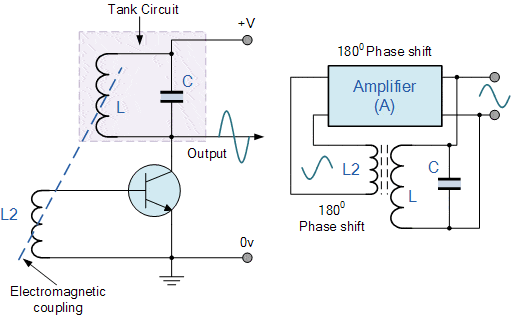

I'm guessing this is the circuit you're modeling ?
I don't think that one would oscillate successfully. It's too linear , would have to have very precise and stable gain. No bias provision for the transistor, either.
I was taught in vacuum tube days that oscillators don't operate as a linear circuit. They develop enough feedback to turn off during part of every cycle. They spend a substantial fraction of their time in "Cutoff", ie zero current through the tube or transistor..
That let's them find a stable operating point , because the approach to cuttoff is nonlinear and clever circuit designers of the 1920's used that property of tubes to achieve the variable gain necessary for stable oscillation.
So I'm not surprised that linear DE's don't work on an oscillator model. The oscillator isn't linear.

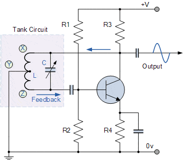

Observe the extra capacitor in this Hartley from that link, at node R1 R2 Base:
That capacitor let's the transistor develop enough DC at its base to hold itself cut off for part of every cycle.
In vacuum tube days that's how we'd tell if the oscillator is running - with our VTVM look for lots of negative on the grid.
We called it "Self bias" and when oscillation ceases you lose it. 10 or 20 volts negative was typical at a grid, i think 2 or 3 is more typical for a transistor base.

Thanks for the analysis Jim. I think that non-linearity is my problem. So how does the frequency get determined for the LC-tank circuits? Most of the frequencies are in a form that looks like f = 1 / (2pi*sqrt(LC)), where LC are often functions of the capacitors and inductors in the circuit--like the Hartley. I want to be able to understand how those got designed, and how to figure out their frequencies. So far every book I have come across just tosses the circuits out and the formulas, then leaves it at that.
LC, LRC: I was speaking of the idealization of a charged capacitor connected in series to an inductor in a circuit without resistance, so the energy transfers between the electric field in the capacitor and the magnetic field in the inductor indefinitely. Adding a resistor simulates the energy loss in the wires, so the oscillations decay to zero.
Now, what's wanted to do was take that basic theory and figure out how to compensate for that loss with a transistor and a voltage source, which is more or less what these circuits do. Well, also the loss of whatever load is applied to v-out.

Just to make sure I'm clear on that nonlinearity, it is when the base current isn't just zero, but the base voltage is less than the emitter--that's the 2 or 3 volts you're talking about? That would make sense, since the linear model I was using (I think) assumes that voltage is always 0.6 or 0.7, depending on the book.
Yes. It develops more than enough "self bias" to cut itself off.
The LC determines frequency. Its damping is low so it'll ring after receiving a pulse. That's the frequency of oscillation.
Look at the bottom Hartley:
When feedback voltage drives base positive the transistor conducts
and that unnamed capacitor in series with base charges + on its left side and - on right .
Note right side can't go more positive than 0.6 volt, the E-B junction is an effective clamp.
So you could get several volts across the capacitor.
When the feedback voltage starts back toward negative a bit later on in the AC cycle, the right side of capacitor gets driven negative however far the AC wave takes it.
So collector current ceases to flow until next cycle.
And the base is driven below 0 volts. The average will be negative when it's oscillating because negative peaks are bigger than positive..
That means the tank circuit gets not sinewave excitation but just a pulse of current every cycle.
That pulse is not even a half cycle wide. But due to the tank circuit's low damping it's plenty to sustain the oscillation. The sinewave will have some distortion from the pulsed excitation current, but it works fine for radio circuits.
When you have your oscillator stable it'll find the conduction angle that gives steady oscillation.
