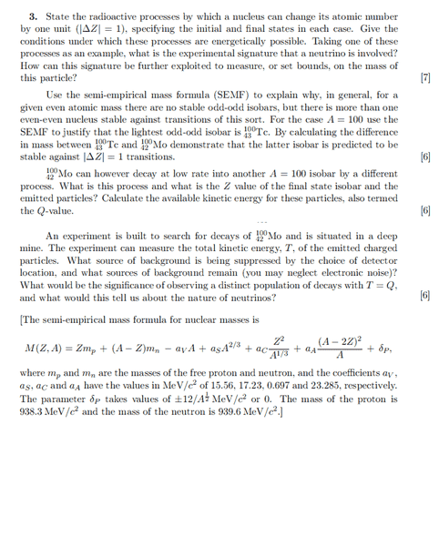

(a) What processes changes atomic number by 1? What are the favourable conditions? How do you tell a neutrino is involved? How can we use this to understand the mass of this particle?
(b) Use semi empirical mass formula to explain why odd-odd isobars are unlikely, while even-even isobars are possible. Why is ##Tc## the lightest odd-odd isobar? Show by mass difference ##Mo## is stable.
(c) What is the other possible process and its ##Q## value?
(d) What background is suppressed and what other background exists? What's the significance of T=Q?

Part (a)
I suppose the two processes are neutron capturing: ##_a ^b X + n \rightarrow _a ^{b+1} Y + \gamma## and fission: ##_a ^b Z + n \rightarrow _a ^{b-1} W + 2n + \gamma##.
I think favourable conditions are an odd-even nucleus? Not sure what other conditions there are.
When a neutrino is involved, I suppose we find leptons? How do we use leptonic decay to figure out the mass?
Part (b)
For an odd-odd configuration, ##\delta_P < 0## so lower binding energy compared to an even-even configuration where ##\delta_P = 0##. Not sure why ##(Z,N) = (43,57)## is the lightest odd-odd isobar. What about ##(41,59)##?
It seems that ##Mo## has a higher binding energy than ##Tc##, so I suppose it is more stable.
Not sure for the other parts of this question..

For part a), it's the atomic number which changes. Which particle determines the atomic number of an atom?
Does fission change the atomic number by 1? Or does fission do something entirely different to a nucleus?

Think of conservation rules, I.e. total lepton number and specific lepton number are always conserved in interactions!
a) Beta pluss and minus decay as you said is the only really viable option, (you can have emission of a proton but this is very rare so i doubt it is what the question asks for). So if we have then don't have a neutrino present we would have a system with ##\Delta L_e = \pm 1##. Consider also if decay of a neutron or proton would result in higher binding energy, and how this relates to the most favorable condition.
b)Look at the last term in the semi emperical mass formula (SEMP), and remember the less mass you have the more energy you need to break the nucleus appart
c)The answer is hinted to in part d, what do we look for in very deep mines? specifically the interaction of what particle?
d)Basically they are asking which particles will be blocked out by a LOT of matter, and what can go pretty much undesterbed through matter? Also if T=Q then all the energy released from a reaction is in the kinetic energy of 1 particle.. so if we know the kinetic energy of the emitted charged particles (ofc you need to figure out what particles are emitted but this is related to part c), what does this tell us about energy of the incoming particle?
