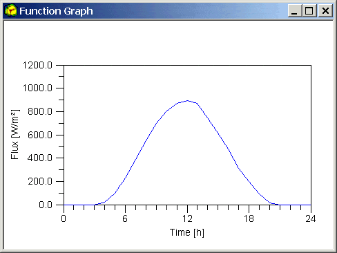

Here's a map of available solar energy per day for every month, let's pick March because it includes the equinox, January is leaner and July is richer.
http://rredc.nrel.gov/solar/old_data/nsrdb/1961-1990/redbook/atlas/serve.cgi
EDIT: map removed it was too wide for screen, it's at http://rredc.nrel.gov/solar/old_data/nsrdb/1961-1990/redbook/atlas/colorgifs/3.GIF
Looks like the sun delivers a daily average of perhaps 3 kwh per square meter per day .
At collection efficiency of , let's be generous and assume 15%, yields 0.45kwh per square meter per day.
Only Nasa can afford those 40% efficient cells for they cost 100X what a commercial 8% one does.
Now the US electrical consumption in 2011 was 3.75 X 10^12 kwh
http://www.ipsr.ku.edu/ksdata/ksah/energy/18ener7.pdf
which divided by 365 yields 1.02 X 10^9 kwh per day, requiring 2.27 X10^10 square meters of collector.
The US has area of 9.16 X 10^ 12 square meters of land area
http://en.wikipedia.org/wiki/List_of_U.S._states_and_territories_by_area
and [itex]\frac{2.27E10}{9.16E12} = .0025 [/itex]
so covering ~1/4% of the whole country with solar panels could make as much electricity as we used in 2011.
That's a lot of solar panels. And to make transmission practical they'd have to surround the cities as do today's steam plants. I suspect their immense size would wreak political havoc with suburbia..
Also they'd only make electricity when sun is well above horizon.
solar insolation graph courtesy http://www.physibel.be/voltra_sol1.htm
I think it'd a better idea to use solar to boost the daytime efficiency of fossil or nuclear steam plants as described in this article:
http://www.nrel.gov/csp/troughnet/pdfs/bruce_kelly_isccs.pdf
for that way we could still watch TV , read Physics Forums and run the dishwasher after dinner.
Thoughts ? Corrections ?

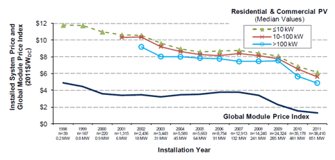

PV costs: "For large-scale installations, prices below $1.00/watt were achieved. A module price of 0.60 Euro/watt ($0.78/watt) was published for a large scale 5-year deal in April 2012."
Correct me if I'm wrong, but construction of a gagawatt nuclear plant costs far more than $1B.
No, they don't have to surround cities. A HDVC transmission line can transmit gigawatts of electricity over a link of more than one thousand miles.
I don't think you're wrong. In late 60's I saw one built for $120 million.
By late 70's that had escalated to ~ 1 billion. Our CEO said of the regulatory environment: "I can't gamble the entire net worth of the company on a plant I may not even be able to run." He went back to coal.
Last I heard the figure was in the $5B range.
