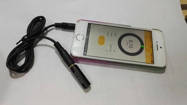

Welcome to the PF. :smile:
Do you have a Geiger Counter in your lab equipment stock? We had one at my small high school, and it was pretty fun and instructive to use. Nowadays you can even get inexpensive USB and Cell Phone versions:

I have some uranium glass, a smoke detector... Do you know if the Cell phone version would give signal above the background for low radioactive materials?

I don't know without reading more about it. Maybe you could look at its datasheet and compare the numbers to what you find from Google searches about your samples. And it's probably a good idea to look at the datasheets for several different Geiger Counter types and models, to see if they are a lot more sensitive (does sensitivity ratio with cost significantly?).
Or have your students do it as an exercise... :smile:
