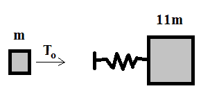

Recall your happy days with collisions in elementary mechanics. If a block of mass m collides with a block at rest of mass M so that they become one block (at least momentarily), what fraction of the initial KE remains? What fraction of the initial KE is converted to some other form of energy of the two-block system?

I'm not positive I'm interpreting the problem correctly. But think of it this way. Suppose you had a block of mass m that is going to collide with a block at rest of mass 11m that has a spring as shown. Suppose that if the spring becomes fully compressed, the system explodes. Thus, there is a certain "activation energy" that the spring must absorb before we get an explosion ("reaction").
If you are told that the minimum kinetic energy that the small block must have initially to get an explosion is To, then you can work out the "activation energy" for the reaction.
This "activation energy" is the potential energy stored in the spring, right?
But I really don't see how to carry this analogy in the given problem. I have the energy lost and final energy of the B^(12) nucleus but what to do with them. :confused: :cry:
If the initial KE of the neutron is below 4 MeV, then the specified reaction doesn't occur. This is because not enough energy is transferred into "internal energy" (analogy: potential energy of the spring). My interpretation of the question is that they are just asking for the minimum value of the increase in internal energy in order for the reaction to "go".
It is very much like activation energy for some chemical reactions. There must be a certain input of energy before the reaction will go. This is different from the energy released in the reaction. Two different chemical reactions could have the same activation energy, but release very different amounts of energy.

Where does the "energy lost" go? Where did it go in the block analogy?

If there were no spring, then in an inelastic collision, energy wasted gets converted in heat or some other form of energy, I guess in the spring case, it gets converted into the potential energy of spring?
Yes. Anyway, my interpretation is that they want this "spring" energy.
