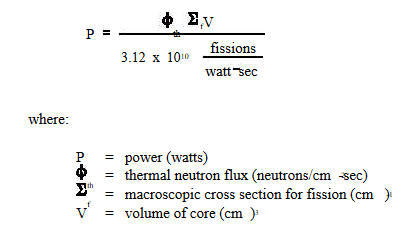

I have also found this equation for power released in a reactor: (I'm assuming its thermal energy)
https://physicsforums-bernhardtmediall.netdna-ssl.com/data/attachments/79/79118-ab7c405aa0d5a08d46da0274ea2c6e3a.jpg
What are your thoughts on my approach?

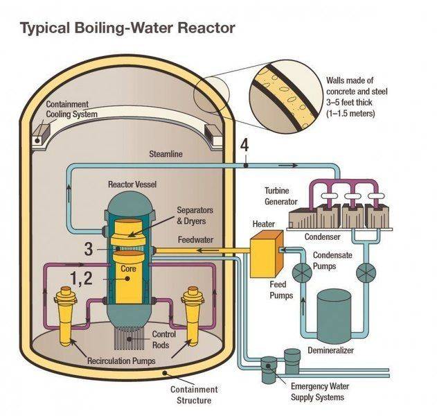

I have attached a diagram of the reactor setup...don't know exactly how accurate it is, but I have a few more questions in regards to this paragraph:
"So control rods are used to raise power up till around 45-50%. At this point, we start raising up the cooling water flow rate in the reactor. Raising the flow rate causes the steam to leave the reactor more rapidly. The steam bubbles are bad moderators, they don't slow neutrons down. If you push the bubbles out faster, the bubbles spend less time in the core, meaning more liquid water is available for moderation. This causes power to go up."
By "raising the cooling water flow rate" do you mean the re-circulation loop shown in pink/purple in the diagram? or the actual loop leading to the turbine? Obviously there are 2 loops for liquid and they don't interact so how are these compartments set up? How is the water to the turbine boiled if at the same time liquid is cooling the core itself."Normally the turbine is in pressure control mode. In this mode, if pressure starts to go up, the turbine throttles open to draw more steam, and pressure stops going up. This makes more electricity. If pressure starts to go down, the turbine throttles close to draw less steam, and pressure stops going down. So for the reactor, this means if I raise power, the turbine will automatically raise output, and pressure remains nearly constant. Normally recirculation doesn't get any feedback and is in manual control."
You say if you raise power, output increases and pressure stays the same. That makes sense...but how are you increasing that power initially..by what method?
Also how do you calculate that power percentage? and what are typical figures in terms of output Watts/temps/pressures for a nuclear power plant - just so I have something to work with..
There's only 1 cooling loop. The feedwater and the recirculation loops are all 1 system. The water going to the turbine is water that boiled directly in the core. When feedwater is added to the core, it sprays in the Downcomer region outside of the core shroud. The recirculation pumps draw suction on the downcomer, and provide flow to the jet pumps, which in turn pump water into the bottom head of the core, and up through the core itself. Water boils to steam in the core, and then passes up through the steam separators and dryers. The moisture in the steam is removed, and travels through a path back to the downcomer where it mixes in with the new incoming feedwater. The steam that makes it out is 99.95% or better quality, and goes out to the turbine.
As you boil water in the core, you get a build up of steam bubbles. The steam bubbles are bad at neutron moderation, and are a source of negative reactivity. To control power, I can either push the steam bubbles out faster or slower. If I push the bubbles out faster, power will go up, and if I push the bubbles out slower, power will go down. That's what the recirculation pumps do. If you raise the flow rate through the recirculation pumps, you have a higher flow of water into the core, which pushes steam out faster and raises power.
The core cools itself through boiling. It takes a lot of energy to boil water, so as water goes from liquid to steam, it is absorbing energy from the fuel. There is a point where you are have too much steam and not enough liquid, where the steam starts to act as an insulator and can cause the fuel to overheat. This is called "Transition boiling" and needs to be avoided at all costs. The core monitoring computer will calculate the Critical Power where this transition boiling occurs. Operators have a safety limit, called "Minimum Critical Power Ratio", which ensures you do not ever go into this transition boiling region.
Raise cooling flow with the recirculation pumps, or pull control rods in the upper 1/3rd of the core. Either method will raise reactor power, which generates more steam and causes pressure to increase. The turbine senses the pressure increase and opens up its throttle valves to accommodate the extra steam being generated.
For a BWR, full power is based on the license, but let's just say a generic large BWR/5 plant is around 3300 MW thermal energy (~1000 MW electric output). A reactor of this size will have around 740 fuel bundles, operate around 1025 PSIG pressure in the core at 100% power, and temperature in the core will be saturation temperature using a steam table (about 545 degF).
Off topic question. The information you have given me is priceless and I'm truly grateful you have given me quite an understanding considering I have come into this knowing nothing...my question is will "Intro to nuclear engineering" books contain this kind of information I ask because I would like to cite it for my report but can't exactly cite a forum.
Take a look at the BWR/6 plant description document http://www4.ncsu.edu/~doster/NE405/Manuals/BWR6GeneralDescription.pdf
This describes how the plant is controlled, all the safety systems, fuel design, basic plant operation, etc.
Page 6-3 describes how rods and flow are used to control power. Figure 6-2 shows how the automatic flux controller is designed to work (although I don't think any US plants use it anymore).
Hope this helps!

I was definitely visualizing that incorrectly, I imagined the re-circulation pumps simply sucking water out and then dumping it back in, like the loop in the diagram I uploaded..couldn't see the point of that.. so if I understood that correctly...by the time the feedwater reaches the core it effectively needs that extra 'push' to keep things moving along?
What is the typical flow rate for these re-circ pumps? or in other words what level does the water need to maintain in the core (how many Liters) ? I'm guessing that comes down to the Minimum Critical Power Ratio?
Are re-circ pumps in use during the period of power rising to 45-50%? I should say what's the rate during that stage and what's the rate after it passes 50%
Exactly right. The recirculation pumps push water through the reactor core.
There is a "Power to flow" map, which shows allowable combinations of core flow for a given power level. For a large (3300 MWth) reactor, the core flow is between 85-100 Million Pounds of water /hr.
They can be. It depends on how the plant starts up and the power to flow profile. My plant has 2 speed recirculation pumps, and we use flow control valves. For us, around 35% power we shift the pumps to fast speed, and we use flow to raise power as high as we can. We don't like running in fast speed at low flow, because it puts more wear on the seals. For the plants with variable speed recirculation pumps, they will usually raise power higher before raising flow. It all depends.
