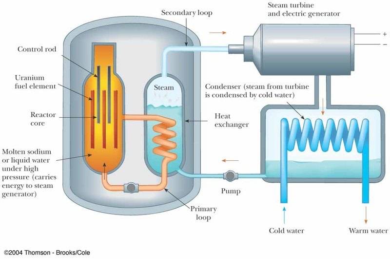

Hi! I realize this is a little late, but energy from the fission is transferred to the primary coolant. Depending on the type of reactor, this coolant can be a few different types of substances, but because I am familiar with it, I generally think of it as pressurized, light water. The energy from the coolant is then transferred to the secondary system containing water. This is where the steam comes from! Fuel>Primary Coolant>Secondary Steam!
There are MANY other parts to a nuclear reactor and its systems. Feel free to ask me any more questions!
