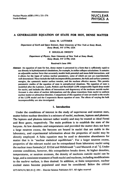

I deal with this paper... http://adsabs.harvard.edu/abs/1991NuPhA.535..331L
I don't know if is possible to access online, but... This is stated in the introduction...for example
I see. This paper is about dense (and not too hot) nuclear matter in thermal equilibrium as it occurs in neutron stars. To understand neutron stars you need to know the equation of state, i.e., the relation between pressure and energy density. That's what this paper is about.
