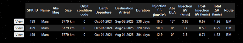

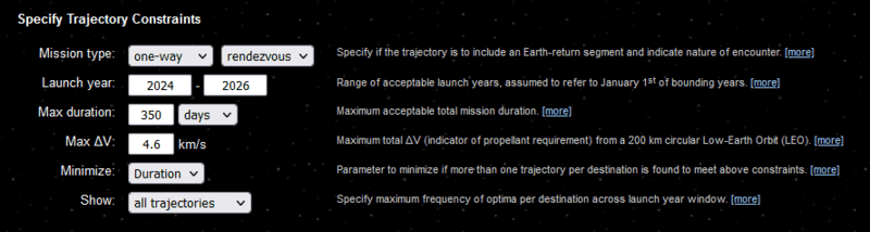

NASA has a web page calculator for such trajectories. The first calculation for an Earth-Mars trajectory using a maximum Δv of 4.6 km/s for conventional chemical rockets and these constraints to minimize duration:
resulted in trajectories taking from 304 to 336 days:

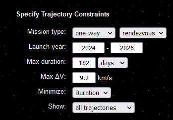

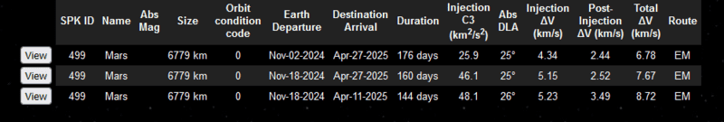

The second calculation for an Earth-Mars trajectory doubling the maximum Δv to 9.2 km/s for nuclear NERVA type-rocket and these constraints:
resulted in trajectories taking from 144 to 176 days:
The trajectories exists for sure, and the duration can get even shorter if waiting for the right launch window is allowed, that is, if the high-energy transfers you listed that costs around 45 km2/s2 can be done as energy optimal transfer with nearly same duration at a different launch date or, in other words, by picking a different launch date you could get even lower transfer times with a high-energy transfer.
Also, with aerocapture (i.e. using fly-by instead of rendezvous in the tool) the number of low-duration transfer opportunities in the next couple of decades seems increases a lot (although some of them might have too high arrival speed for aerocapture), so that might also be an option, at least to the extend aerocapture can be considered a realistic capture option for a crewed vehicle.
By the way, regarding opportunities there is also a nice collection of Earth-Mars transfer opportunities listed in https://ntrs.nasa.gov/api/citations/20100037210/downloads/20100037210.pdf that can be used to ball-park energies and transfer times.
But all that said it would still be interesting to see a serious mission design that actually planned with a short duration crew transfer (it may very well exists, I am just not aware of any). I assume such design would have to be a multi-vehicle/phase mission where equipment needed for exploration on Mars are placed in orbit or on the Mars surface before arrival of the crew, as this is likely to be a flexible (albeit expensive) mission design template even without access to NERVA or similar effective propulsion, and this is (as I understand it) also the current template used by NASA and others for manned Mars mission designs.

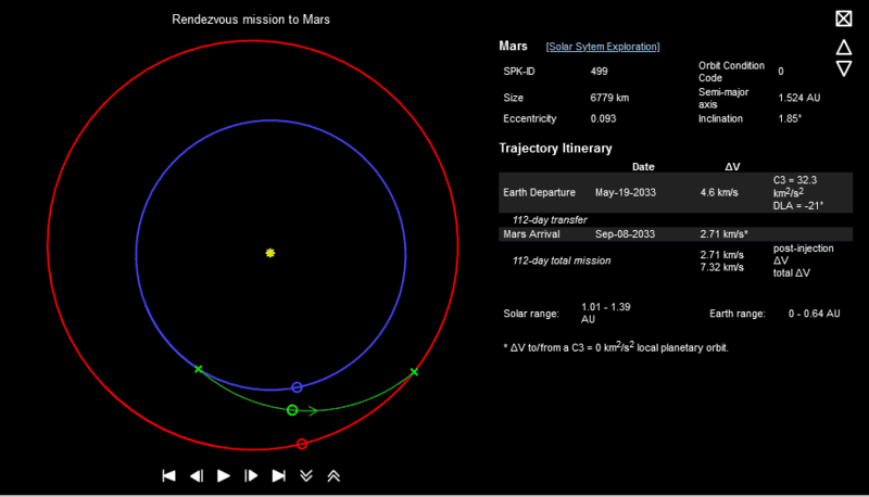

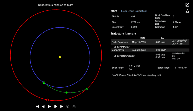

Using the link you provided, I was able to find the quickest trip to Mars which has a launch date of May 19, 2033 and only takes 96 days:
There is a slightly longer trip - lasting 112 days - leaving the same day but with a smaller total Δv:
The higher eccentricity of Mars' orbit and the almost 2° inclination of its orbital plane relative to the Earth's orbital plane make the timing of the launch particularly important.
