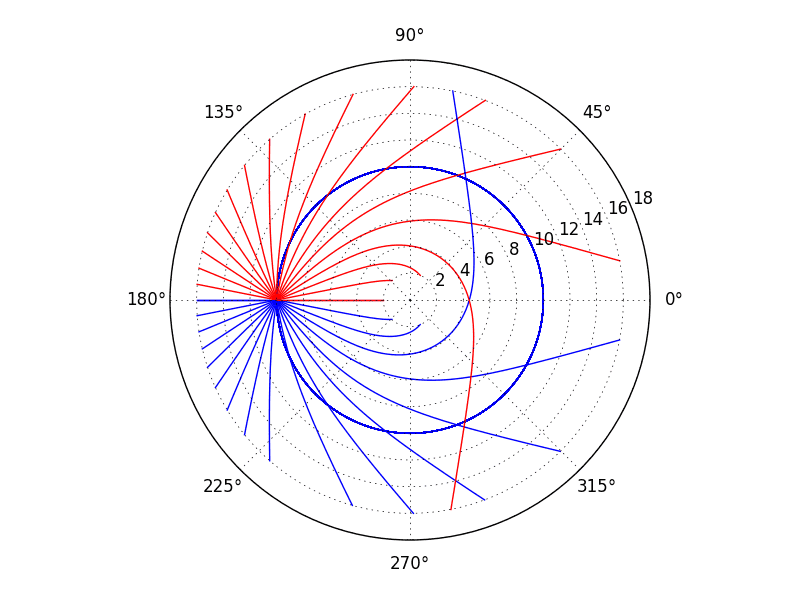

So that's it. There is an awkward differential equation to solve to get ##r(\lambda)## but, given ##r(\lambda)##, you can invert the definitions of ##E## and ##L## and integrate to get ##t(\lambda)## and ##\phi(\lambda)## respectively. I used scipy's scipy.integrate.ode with the "dopri5" integrator (the documentation says it's by Dormand and Prince, and cites E. Hairer, S.P. Norsett and G. Wanner, Solving Ordinary Differential Equations i. Nonstiff Problems. 2nd edition. Springer Series in Computational Mathematics, Springer-Verlag (1993)) for ##r## and a straightforward trapezium rule for the other coordinates.
There are two gotchas. The first is that we have to "guess" the sign from the square root in the ##dr/d\lambda## expression, and the sign flips for paths that approach and then leave the hole. I ended up terminating my integrator when it tried to run through the ##dr/d\lambda=0## point and restarting it with a manually flipped sign (incidentally, the basic "vode" integrator in scipy.integrate.ode didn't always approach the zero closely enough before failing, and you could get paths with kinks in them). The second gotcha is that if you set ##\psi=\pm90^\circ## then ##dr/d\lambda=0## and the light goes into a circular orbit. This is an error; ##d^2r/d\lambda^2\neq 0##, but I couldn't persuade the integrator to recognise that. So I cheated and tweaked ##\psi## slightly if it was input as 90°.

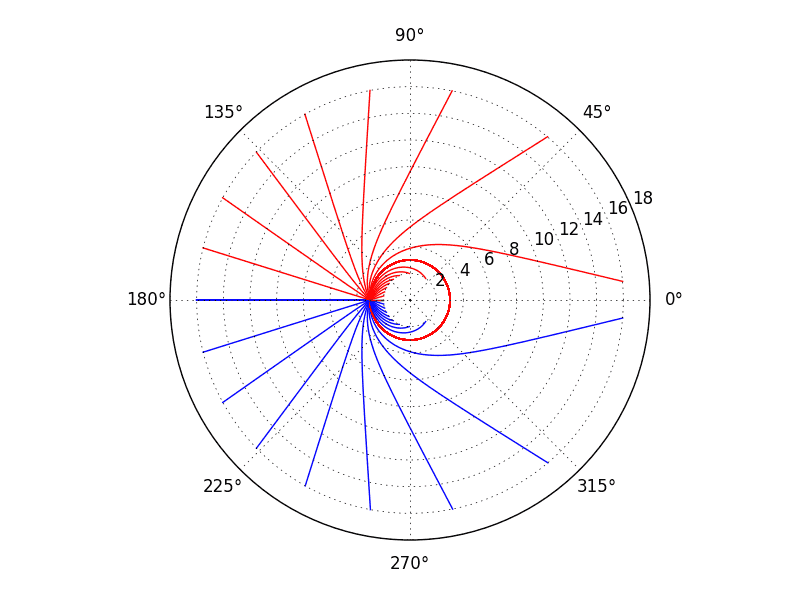

So here's the output. It's two sprays of laser pulses at 10° intervals. The Schwarzschild ##r,\phi## coordinates only are plotted - so these are worldlines rendered in ##\mathbb{R}^4## in Schwarzschild coordinates, but with the ##t## and ##\theta## coordinates suppressed to fit on your puny Earth screens. Radial scale is in units of ##GM/c^2##, so the event horizon is at r=2.
That was fun!

With thanks to @George Jones, here's a version comparing the two approaches to numerical integration - red is George's approach, blue my old approach. I took out the cheat handling of 90° - note the odd behaviour of the blue line, but that the red line is consistent with the geodesics either side. Other than that, there's very little difference to the eye, but George's is a much better approach in the background. Each path is being done completely by one pass of the same integrator - no add-on trapezium rule for ##\phi## and ##t##, and no mucking around with manual resets (although you still have to select the sign of the square root for setting ##p## at ##\lambda=0##).
PS: I did have a good (and non-physics-related) time with family today, but have been looking forward to trying this out once everyone had gone home and my son was in bed.
...and a sanity check: does the revised integrator give a circular orbit at ##r=3GM/c^2## (it should)?
Yes!
