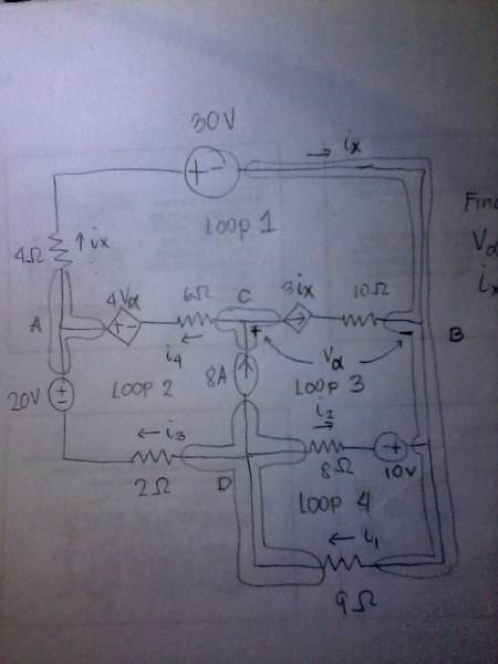

Find ix and Valpha
[/B]
KCL
KVL
[/B]How do I determine the number of KCL and KVL equations? In this problem I am solving, there are 6 unknowns so I need 6 equations. I can write 4 independent KCL equations, 1 KVL at loop 1(to include the Valpha variable) and 1 KVL at loop 4. But these 6 equations result to math error on my solver. Is this because Valpha appeared only once in all equation? Can I also KVL on combined loop 2 and 3 to produce another equation with Valpha?

How did you write KVL for loop 1? That is, how did you treat the voltage across the ##3 i_x## current source? If you just called the voltage across that whole branch ##v_{\alpha}## then it doesn't take into account the effect of the 10 Ohm resistor in the branch.
What I would suggest doing is to introduce a new variable, say ##v_x##, as the unknown potential drop across the ##3 i_x## current source. That let's you write an expression for ##v_{\alpha}## in terms of this new voltage and the potential drop across the 10 Ohm resistor. Replace the ##v_{\alpha}## in the controlled current source with this expression, too, so ##v_{\alpha}## disappears for now.
Then you can write KVL for Loop 1, Loop 4, and around the perimeter of Loop 2+3 (so you don't pass though the 8 A current source and have to introduce yet another unknown voltage). Then write KCL for each node. That should give you a total of 7 equations. With 6 unknowns ##(i_1, i_2, i_3, i_4, i_x, v_x)## you need to pick 6 equations out of the seven.
When you choose the right one to leave out the resulting matrix will have a determinant that is nonzero. In other words, one of the equations will turn out to not be independent. I find that a reasonable approach is to choose equations so that every column has at least two entries. (Each column represents one of the unknown variables, so you want all of the variables to appear in at least two of the equations).

Note that i4 and ix are linearly dependent. In other words, i4 is carrying the same information as ix. Don't use the KCL equation at node C.
Write 3 KCL equations at nodes A, B and D.
Write three KVL equations, around loop 1, loop4, and around the outside of loop 2 and 3. Just keep Vα as Vα.
The 10 ohm resistor is in series with a current source, so it isn't involved in the solution.

If you write the KCL equation for node C, it is "i4 = 8 - 3 ix". If you know i4, you also know ix. i4 is linearly dependent on Ix, and vice versa.
Have you tried solving the 6 equations I suggested you use?
