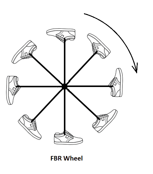

Why not use FBR wheels? You know, where FBR stands for “Forget Born Rigidity”. See picture below. A top of the line model would have many more (smaller) shoes more closely spaced than the one shown. Before the wheel is set spinning, the shoes are equally spaced around the circumference.
We imagine the car is initially floating at rest in deep outer space in some inertial frame and the wheels are not yet spinning. We next get the wheel spinning by using the BS mechanism, where BS stands for…you guessed it… “Bell Spaceship”. That is, at t = 0 in this frame each shoe begins accelerating tangentially to the circumference (by a small rocket thruster attached to the shoe, not shown.) In this frame, the shoes accelerate with the same acceleration for the same time until they obtain ##\gamma = 2## relative to our car frame. Consecutive shoes have therefore not changed their relative separation distance according to the frame of the car.
Of course, in an instantaneously comoving frame of one of the shoes, the distance to the next shoe has about doubled. But since the shoes are not connected to one another along the circumference, we have eliminated most of the Born stress that would occur in a standard wheel. FBR!
Now that the wheels are spinning, we can imagine another inertial frame that is moving relative to the car frame at ##\gamma = 2##. This frame has an 8 m stretch of road lined up with the relative motion of the car. In this frame, the car is going to zoom past with the wheels of the car just touching the road. The shoes of the FBR wheel will be “running” along the road with zero relative velocity between the road and any shoe that is touching the road.
Now we can ask how many revolutions the wheels make in traveling the length of road.
[Ok. OK. For you serious types, this was meant only as an amusement. Happy New Year to everyone!]
