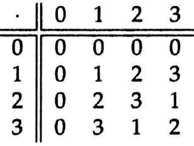

The solution in the book was
I don't really understand how they get ##2 \cdot 2 = 3## and ##3 \cdot 3 = 2## and ##3 \cdot 2 = 2 \cdot 3 = 1##. I know that multiplication in a field is commutative so a \cdot b = b \cdot a thus ##3 \cdot 2 = 2 \cdot 3 ## but I don't know why it is 1 and not 2.
Lets take one of these as example:
##2 \cdot 2## is 4 right? Then when we calculate the the remainder in respect to 4 ( as it is 4 elements in the field and a field is by definition a commutative ring, right? and we want the answer to be another element in the ring) so it becomes 0. That is ##R_4(4) = 0##. For ##3 \cdot 3 = 9## which produces the remainder ##R_4(9)=1##.
Could someone please help me with what I am doing wrong and how I should solve it instead? Please be specific. Tell me how I should tackle this problem.I am not asking for a solution but for the procedure for these kinds of problems.
\begin{array}{|c|c|c|}
\hline \cdot & 0 & 1 & 2 & 3 \\\hline
0 & 0 & 0 & 0 & 0 \\\hline
1 & 0 & 1 & 2 & 3 \\\hline
2 & 0 & 2 & 3 & 1 \\\hline
3 & 0 & 3 & 1 & 2 \\\hline
\end{array}

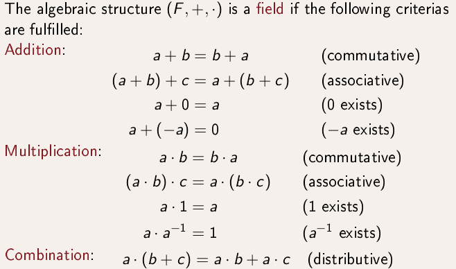

First question to ask (and answer):
What is the definition of a field?
Notice that in your proposed definition of multiplication, 2 has no (multiplicative) inverse.

With that and the equations I gave you, ##3 \cdot 3 - 1 \cdot 1 = 3 \cdot 3 - 1 = (3+1) \cdot (3-1) ## and ##3 \cdot 2 = (2+1)\cdot 2 = 2 \cdot 2 + 2 \cdot 1##
you can consecutively deal with the cases ##3 \cdot 3 = 0## , ##3 \cdot 3 = 1## , etc. and see which one will lead to impossible solutions and which doesn't. Btw. I did not take 3=2+1 as naturally given, I looked it up!
