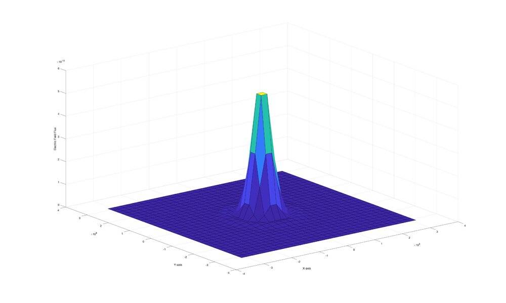

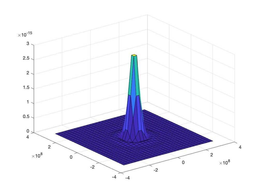

- Homework Statement
- First I'd like to take the (known) analytic approximation of Kirchhoff Integral and plot it in the far field. I'd imagine the scalar quantity ##\psi## is most closely related to the Electric Field Vector ##\vec{E}## so that is what I'll focus on for the second part.
Then I'd like to evaluate the Kirchhoff Integral in a way that is completely numerical.
I would then like to compare the two approaches graphically. As it is right now they are orders of magnitude off from each other.
The set up I'd like to entertain is a plane wave normally incident on a circular aperture in the ##xy-plane## and graph the flux through a ##z = constant## plane.

The result I get is (Thumbnail)
Now for the second approach and result

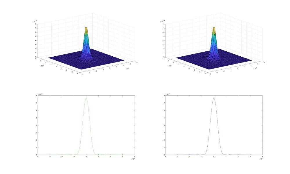

When I plot it against xy (like in the last picture I get) (Thumbnail)
I assume I didn't do anything stupid like make the wavelengths different, distances different, etc I think my I'm off by a constant of some sort but I don't know which one makes sense my units are right as far as i can tell.
In the first picture and second picture respectively we have a peak of
##2.8 \times 10^{-15}##
##5.2 \times 10^{-13}##Off by two orders of magnitude.
Can anyone point out where I messed up on my units If that is indeed the case.
