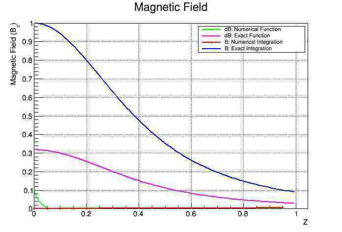

Calculate the magnetic field of a current loop. Compare your numerical results with exact solution above the center of the loop. Investigate the effect of the grid size based on this comparison.
dB = u0*I/4pi * (dL * R) / (R^2 + Z^2)^3/2
Bz = u0*I*R^2/ (2 * (R^2 + Z^2)^3/2 )
I've tried to paste this into my numerical integration program from a couple of assignments ago (as per instructions). I'm using the trapezoid rule to do my integration. This is my code:

I've tried plotting them to see kind of where I am and this is what I'm getting:
. And the red line isn't even close the blue line like it should be.
I read the problem statement differently: they want you to calculate generally. The restriction to points on the z-axis is only for the comparison, because there you have an analytical solution to compare with. Link section 9.8 can help with the general case.
Again: z is a constant. It shouldn't change inside the integration loop. You only integrate over ##dl = R d\phi##.

dl appears twice in the integrand and as integration variable. I don't trust the 2 pi there either !
dB[loop + 1] = (u0 * current * radius * dl) / (4 * pi * pow((pow(radius, 2) + pow(x, 2)), 1.5));
B[loop + 1] = B[loop] + weight * 2 * pi *(dB[loop + 1] + dB[loop]) / 2 * dl;
You want to remove the red stuff...
[edit] sorry, copied from the quote of post #1.
dB[loop + 1] = (u0 * current * pow(radius,2) * dl) / (4 * pi * pow((pow(radius, 2) + pow(x, 2)), 1.5));
B[loop + 1] = B[loop] + weight * (dB[loop + 1] + dB[loop]) / 2 * dz;
So only the dz is suspicious. Factor 20 nevertheless.
z is in the loop not for the purpose of integration, but so that I have an array for the axis range
I'm still afraid that what you plot is not what you think you plot. I also don't understand it. If your table has constant dB, then how can the green line drop like a brick ?
Again: during the integration loop you don't want to save or plot anything. You want to vary x/radius and plot B(x/radius) / B(x=0)
