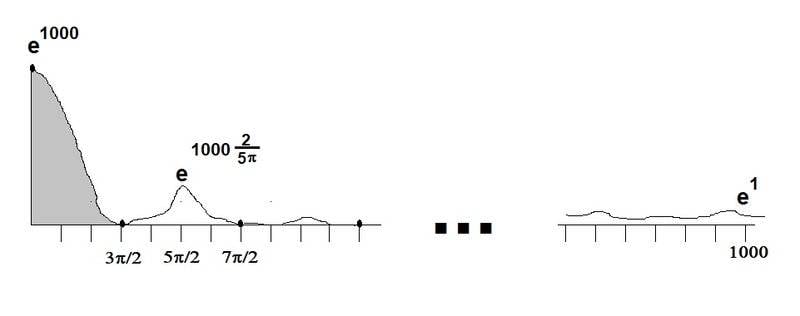

The integral looks something like this:
  • The function starts out absolutely huge: ##e^{1000}##.
  • It drops to almost zero at ##x = \frac{3\pi}{2}##
  • It goes back up to another huge number: ##e^{1000 \frac{2}{5\pi}}##
  • It goes back to almost zero at ##x = \frac{7\pi}{2}##
  • It continues going up and down, with the ups getting smaller and smaller and the downs getting larger and larger, until near ##x=1000##, the function is just meandering up and down between the values ##e^0## and ##e^1##.
The approximation that I gave is roughly equal to the first region (colored in gray), up to ##x= \frac{3\pi}{2}##. But it ignores all the rest. However, we can get an estimate for all the rest, in that it's certainly less than ##1000 e^{1000 \frac{2}{5\pi}}##. So if the area of the first region turns out to be really huge compared to this number, then I think my approximation will be close.
