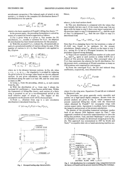

I couldn't read the paper other than the references. The rest was blank.

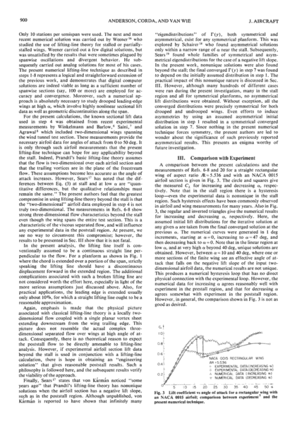

Oh, I can see the rest of it. Here is the algorithm I followed.
