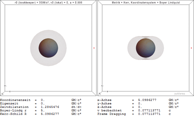

An infalling particle should spiral in like this:
