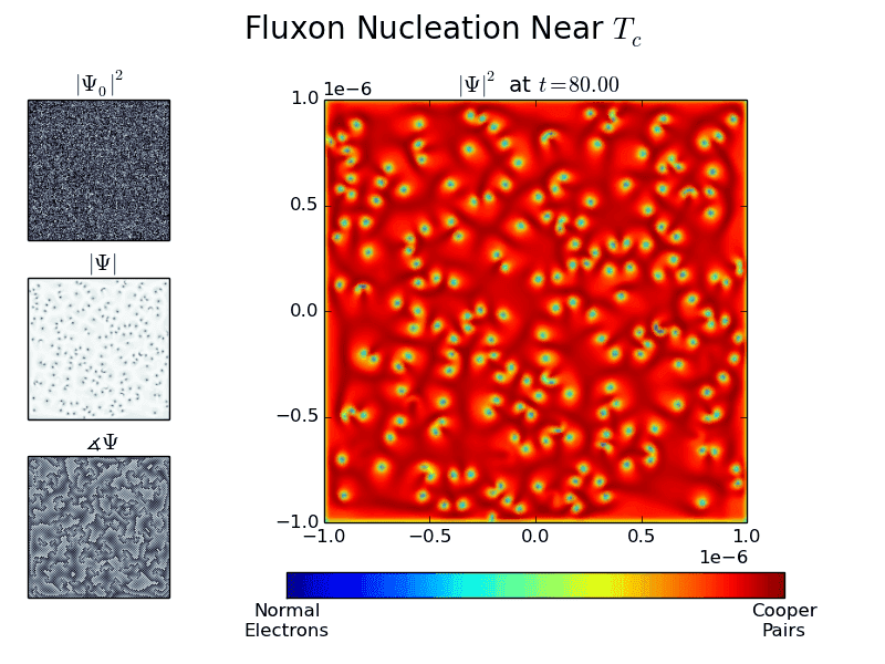

At the moment, I am trying to push forward with what I have... I don't know how to upload a video to PF, but i think I got something that make sense to a neophyte in superconductivity (my background is in electrical and computer engineering). I randomly initialized a complex field (the order parameter). Over time, the system seems to demonstrate fluxon nucleation... this is to say, normal cores in a sea of superconducting fluid.
Some updates for Twigg and now you Strum...
  1. The fluxon cores do not seem to move. I assume this is because they have enough space not to demonstrate their inter-repulsive forces.
  2. The cores seem to have a very low concentration of superfluid, consistent with GL theory.
  3. The simulation seems to overflow at times... I suspect this has to do with the 5-point stencil I am using to compute the Laplacian. The convolutional kernel I am using does not divide by 4, nor does it take into account the spatial resolution of the simulation (ie. h)
  4. The simulation runs slow. I may need to move over to a GPU to do the computations, I want to do this in 3D.
  5. I can generate images and video that look pretty, but that doesn't count for anything technical. I somehow need to validate this thing.
So now, I am looking for two things in the short term as I review the suggested doc...
  1. Getting my Laplacian to work more numerically accurately and not produce overflows.
  2. Find some sort of validation strategy.
  3. Buy an new laptop with a GPU. o_O

Before you start shopping new computers, is the code you're using to take the Laplacian your own original source code? If so, did you use sparse matrix encoding? I have never had an issue with a Laplacian matrix being too big for the processor to handle, even in 3D, while using sparse matrix encoding. Granted, it could still be that you are asking for higher resolution than I have ever attempted. But I was able to solve Poisson's equation on a MacBook Pro from 2011 using this approach with fifty to a hundred nodes per dimension. A friend of mine was able to take this simulation code and put it in a loop to simulate tens of different geometries and display the results as a real time movie, without buffering the simulation data. I have a hard time believing the Laplacian matrix itself is your biggest demand on memory. Can you verify this?
I'm unfamiliar with the physics involved, so I'll have to review these papers before I make any further comments. I just figured you might want the above information before you invest in a new laptop.
It looks like MATLAB colormap. In MATLAB depending on your implementation you do not need a matrix formulation. You can directly vectorize the input. It is a bit hard to see the lattice size but already 512^3 needs some memory.
For validation, perhaps you can look at the velocity statistics of the vortices( which I by the way recall as moving, either anihilating or repelling. Perhaps the friction coefficient can make them stationary?)? You could look at this paper:

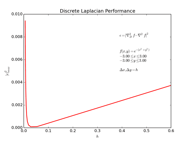

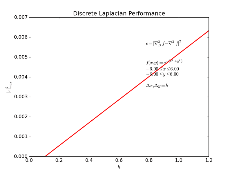

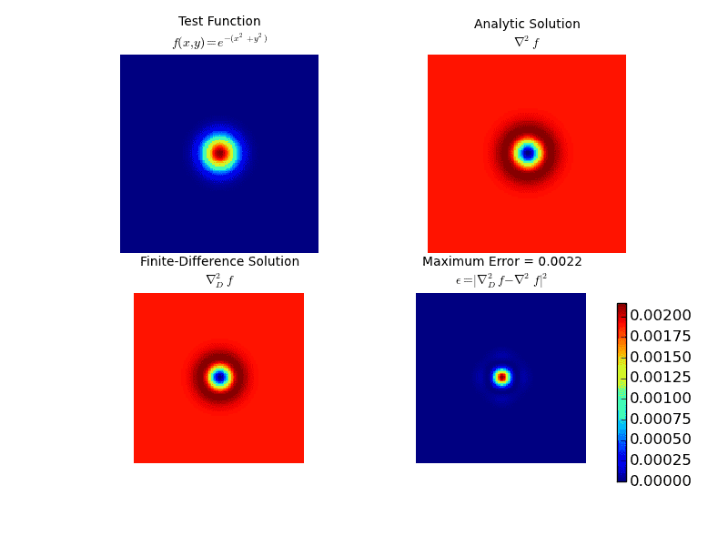

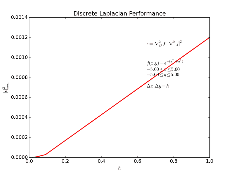

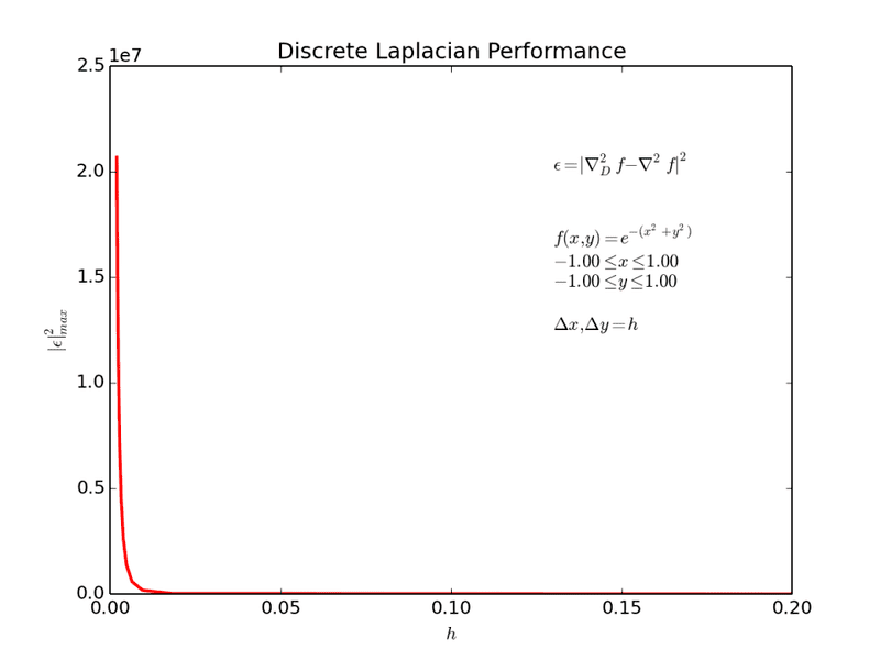

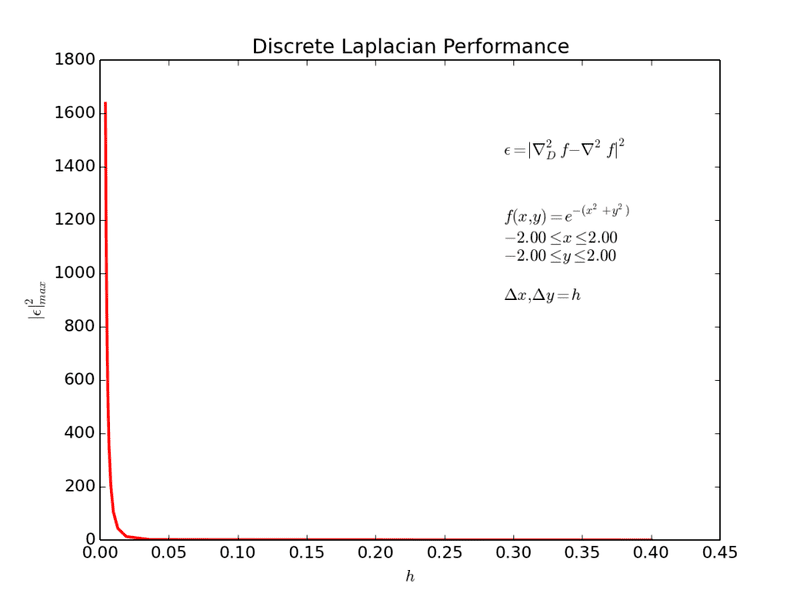

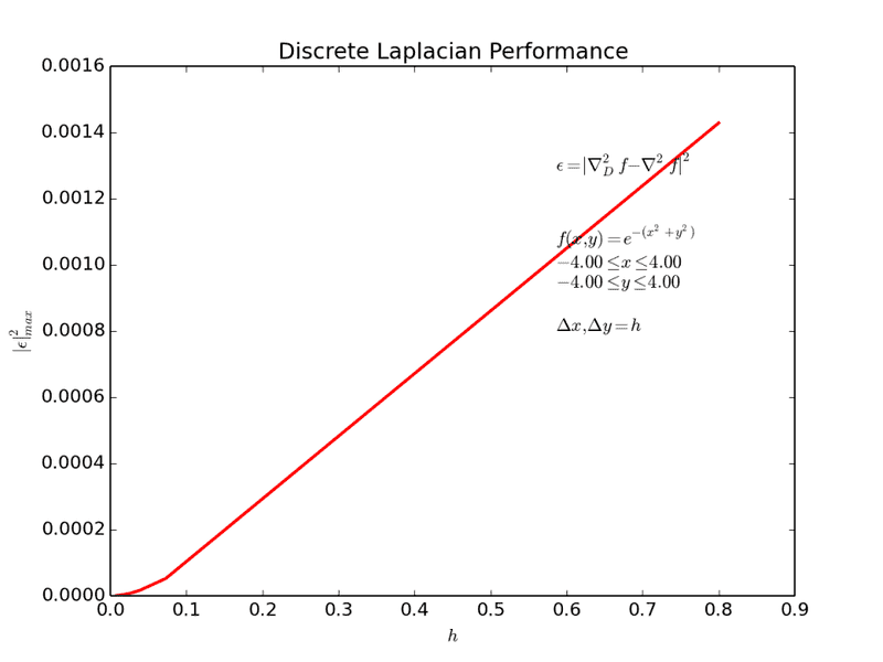

Okay... seems like my implementation of the Laplacian has some performance issues.My validation method:
  1. Used a 2D function and computed the symbolic Laplacian so I had a perfect reference: f(x,y) = exp(-x2-y2). This is a single 2D hump centered at (0,0). Most of it vanishes at a distance of 2 (radial) units from this center.
  2. Set up the discrete Laplacian function: 5-point stencil & convolution.
  3. For various domain extents (the range of x and y), I computed the error between the analytic and discrete solutions.
  4. Generated error plots for each range, with varied values for h (the finite difference step).
  5. BONUS: A psuedocolor plot of the surface as well as the error surface resulting from the aforementioned comparison.
Attached are the results (plots are annotated).
Now this was an INTERESTING exercise. The maximum error that results can be dramatic. As the domain extents come closer to the hump's center (the domain region clips the hump. This is to say, the function is not allowed to vanish. Edge effects take a serious toll here. This is what is likely causing my overflow problems. As the domain is extended further away from the center, the function begins to vanish and the error vanishes as well.
I suppose, my question is... is my convolution method just a quick and dirty method of computing the function Laplacian or is there a better way. I know Twigg mentioned a method that involved sparse matrices. I did some thinking while driving and tried to figure out why he mentioned this. Now I can see this as another method (compute the finite difference at each point on the vectorized surface and solve the resulting system)... Can I get more information on this, like an algorithm name?

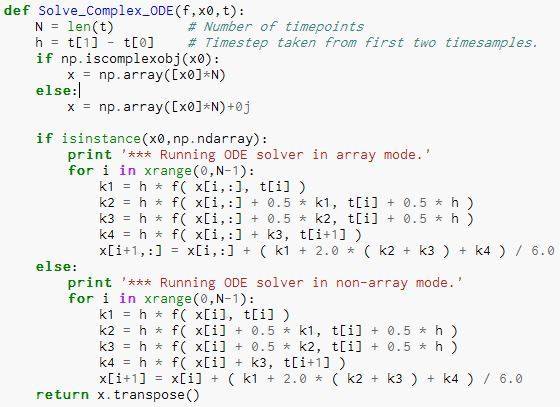

Also if you do not mind I would like to see your Runge-Kutta code. I never got around to really learn this method despite it being all over the place.
This is not an ideal posting, but I could not ignore your request despite the forum's poor rendering ability (AFAIK).
This will work for 1D or 2D functions (the second block is straight from the textbook for simple ODEs). With some modification, you can use it to solve state-space equations. If you do any engineering, you can simulate some pretty cool systems. I actually implemented this code on a microcontroller and it worked. I had a real-time thermal simulator. I could heat or cool a virtual piece of material arbitrarily and monitor its temperature. I found it to be pretty impressive, but coupled ODEs are even cooler.
I thought this was what you were doing all along. Sorry for misunderstanding! I don't know the fancy name for it, but what I did is I constructed a 3D discrete Laplacian sparse matrix using kronecker products. There's a formula for that on wikipedia. For example, if I had a 2D 3x3 mesh, I would ordinarily need a 9x9 discrete Laplacian matrix with 81 entries. Using sparse encoding, you cut that number down to only the nonzero entries, which are only a few diagonals, and save a lot of memory. I think the math is the same as the convolutional kernel you are describing. It speeds things up a lot.
I have a speculative theory on this, hopefully it is productive. This convolutional kernel business doesn't seem to take spatial boundary conditions into account. I'm basing this off my experience with the discrete Laplacian method I described above (which, if you think about it, uses the same principle) and Jackson's treatment of Green's functions. The convolution matrix method to me seems like taking an integral convolution, which is like taking the convolution of a Green's function with a source distribution. Green's functions depend on the boundary conditions (explained fully in Jackson, or just take an image charge as an example). For some more concrete connection here, when I used the discrete Laplacian matrix method (which I _think_ is mathematically identical to the convolutional kernel), we had to delete all entries for mesh points on the boundaries, edges, and corners of our rectangular grid and insert driven constraints from physical considerations. It doesn't give you the usual discrete Laplacian when you consider boundary conditions (Dirichlet or von Neumann, either one changes stuff up). In the case of Dirichlet conditions, I would replace an entire row of the Laplacian with a row consisting of a single '1' and all others '0's, and put the corresponding data point in the solution vector. The problem I was working on was a heat transfer problem, so I didn't have any true von Neumann conditions to work with, but for boundary heat sources I had to use a modified row for the discrete Laplacian, which I figured out a pattern for by doing simple examples by hand, plus the heat source coming in from the outside. I don't know if these simplified boundary conditions are helpful for your application, but I have a hunch that boundary conditions are what's causing your edge-related errors.NOTE: The discrete Laplacian formula from wikipedia doesn't include boundary effects either! I had to derive a pattern/strategy by doing very small cases by hand.
I don't think I made this very clear in my last post. The ordinary discrete Laplace operator that's described in the paper you posted works for any point on the interior of your domain. In the presence of boundary conditions, you modify the operator on points on the boundary accordingly. The interior point Laplacian operator expects for every mesh cell that it is surrounded by six other mesh cells. I suspect that your overflow errors are due to the Laplacian "looking" for mesh cells that aren't there because of the finite extent, if that makes sense.

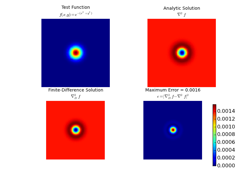

@Johnny
A max error on the laplacian of around 0.005 for even large dx for this function seems pretty good to me. On the other hand in your 2d plots it looks weird that the error does not go towards zero away from the middle( assuming red is not = 0. You should put in a colorbar on those plots ). My own fast implementation of both 5 and 9 point stencils goes to zero pretty quickly,

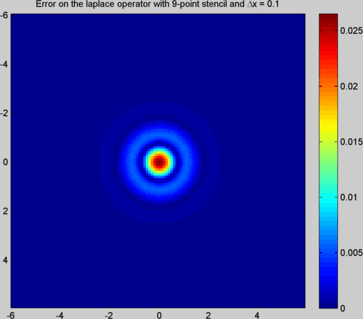

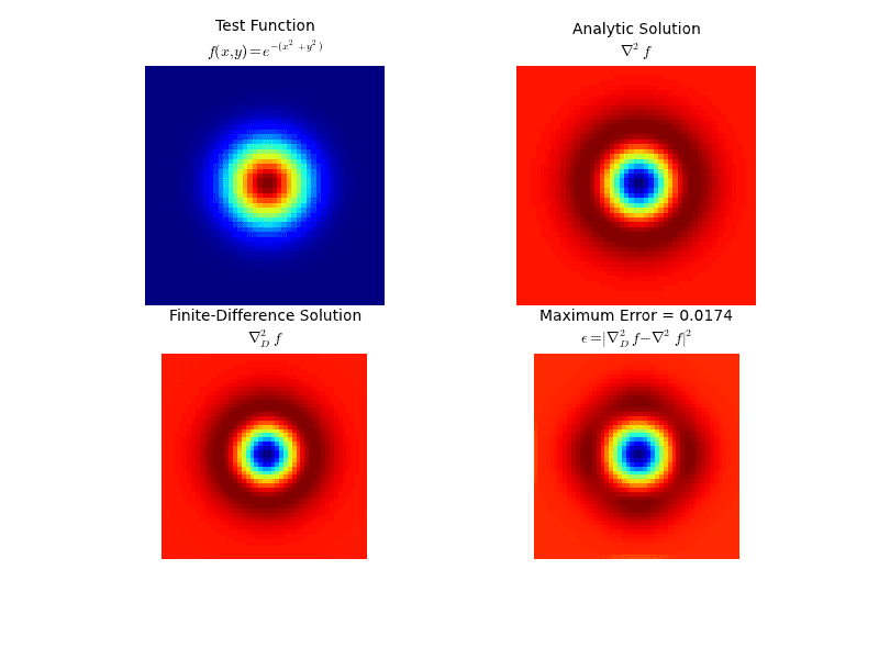

I can't seem to figure out how to edit the post :/. Here is a pic of the error I get
http://tinypic.com/r/25tjkm1/9

I needed to take some time to think about this whole thing. The convolution method I was working with has a spectral response. By this I mean mean the finite boundary extents should yield oscillations at the extents, and these are related to the spatial step size. When I initialize my array with uniformly random values (from the complex unit square with length less than or equal to one), relative to one another, these are all 2D step functions. For example, for an arbitrary array location (i,j) assume I have a random value of 1+0j. Adjacent to it, say at (i+1,j-1) there may be a value of 0+0j. This is a sharp discontinuity whose second derivative is quite large.
For a sufficiently large initialization array with values that are locally discontinuous the Laplacian can yield large values, especially the way I am iterating for the Runge-Kutta algorithm... repeatedly calling the Laplacian operator. I am just throwing ideas around... what do you think?
(How did you get your pic to appear inline?)
I notice you are using a 9-point stencil here, while I was using a 5-point stencil (on the rectangular grid, you are taking diagonals into account while I am not). You were also using convolution here?

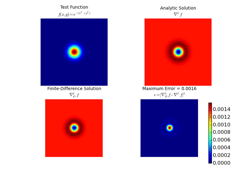

Strum, without knowing the exact 9-point stencil you used I tried to replicate the plot you produced (in Matlab I assume?). Apparently, there is no standard for the 9-point kernel although there is some consensus on the 5-point kernel. Different formulations of the finite difference formulae will yield differing kernels. So when I use a 9 point kernel, I obtain the following for the same domain and [itex]\Delta x = \Delta y = h = 0.1[/itex]
It seems like I get a very small [itex]|\epsilon|^2[/itex]By the way, the reason I am insisting on using convolution is purely for computational reasons: it can be done in hardware (ie. GPU). It seems like we both have comparable rates. The 5-point stencil yields the following result:
Notice that there are some artefacts that appear about one of the "color rings" in the last errror plot. Were you using another method other than convolution?

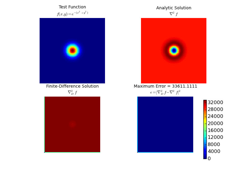

Twigg said:
There is a way you could test to see if these differences are what's giving you the overflow. Go into your initialization code where you sample random points from the complex unit square and make the radius of the complex square a variable, not necessarily 1. For clarity, let's call the size of the complex square that the initial values are sampled from g, and let's call the stepsize h. Write a for loop to run your simulation for several values of g and h. My instinct would be to have it do orders of magnitude. For example, the loop would start with h = 1.0E-03 and g = 1.0E-03 and run your simulation, then do h = 1.0E-03 and g = 1.0E-02, etc., then h = 1.0E-3 and g = 1.0E3, then h = 1.0E-02 and g = 1.0E-03, etc etc. If you are right and the issue is entirely due to large differences in the Laplacian, then the overflow error will only depend on g/h. If you plot the overflow error over the gh-plane, the resulting surface plot should be independent of the radial coordinate and depend only on the angular coordinate (on average, at least, since the initialization is randomized). If that's not the case, I would venture to say that something else is up. This may take a lot of computing time.
This might take some time to do which I don't think I have. What I did do was to test the Laplacian I implemented with a function that did not vanish at the borders. In other words, I used the same function, but biased it by 1 and computed the Laplacian with 0 as fill values at the border. Essentially this forms a crisp edge. The function used was:[tex]f(x,y) = {{\rm e}^{-{x}^{2}-{y}^{2}}}+1[/tex] Note the last term. The analytic Laplacian was found to be:[tex]\nabla^2 f = -4\,{{\rm e}^{-{x}^{2}-{y}^{2}}}+4\,{x}^{2}{{\rm e}^{-{x}^{2}-{y}^{2}}}+4\,{y}^{2}{{\rm e}^{-{x}^{2}-{y}^{2}}}[/tex]
The 9-point stencil was convolved over the discretized function ([itex]-6 \leq x,y\leq 6, h=0.1 [/itex]). The convolutional function was called with fill values of 0 at the boundaries. The result:
And look at those errors! 6 orders of magnitude greater than the previous test result I posted. It seems the convolutional method does not respect boundaries as expected. Next experiment. Convolution using a "wrap" at the end of both axes, ie, the domain is a torus. This continuous domain yields (for the same function):
And now look at the boundary. My conclusion seems to be converging to:
In computing a discrete Laplacian, it seems convolution with a 5/9 point stencil (or any other) works on continuous boundaries - not on discrete ones, despite what fill values you insert at the boundaries.
What do you folks think about this conclusion? Make sense?

At the boundary, I need for the order parameter to be zero, ie [itex]\psi=0[/itex] at the boundaries. What is the name of a method I can use that does not employ convolution to enforce these boundaries? I know we mentioned the use of sparse matrices... is there a name for this method so that I can look it up?
I used a simple 5 or 9 point finite difference stensil.
You result in #28 is to be expected since you are differentiating a function given by ## f(x,y) = e^{-(x^2 + y^2)} + 1 ##, in the interior and ## f(x,u) = 0 ## on the boundary. That will generate problems. This however, is not the situation you will be in when doing your simulation, where the G-L field will find a natural solution with ## \psi = 0 ## on the boundary.
I am not entirely certain I understand what you are saying but I am suspecting it does not make sense. There is no problem specifying Dirichlet boundary conditions using all sorts of different numerical methods.
Johnny_Sparx said:
At the boundary, I need for the order parameter to be zero, ie ## \psi=0 ## at the boundaries. What is the name of a method I can use that does not employ convolution to enforce these boundaries? I know we mentioned the use of sparse matrices... is there a name for this method so that I can look it up?
Perhaps you should try and use a finite difference method. See for example these slides: http://people.sc.fsu.edu/~jpeterson/notes_fd.pdf . In order to enforce your boundary conditions you extend the lattice with a boundary layer with a specific value( in your case ## 0 ## ), which you do not update. This is shown on slide 16. On slide 18 the differentiation matrix for a finite difference method is shown. As you can see it is sparse.
Finite difference is the method I was thinking of. Specifically, a central-difference scheme for the Laplacian. The catch is that your problem is non-linear due to the ##|\psi|^{2} \psi## term. You will need to use Newton's method to get a solution, and that opens a new can of worms with convergence and validation. I've never tried this personally, but I know at least one piece of commercial software (COMSOL) that uses Newton's method to solve the matrix problems of finite element methods.
Is there a way to adapt your existing code to initialize the order parameter on the boundaries to 0 and then tell the convolutional kernel to act on everything but the outermost cells? That might make a lot more sense if you already have a method that works. For example, if your initial data was [0, 0, 0, 0; 0, 0.3+0.5i, 0.5-0.2i,0;0,0,0,0], then you would tell the convolutional kernel only to operate on the inner two entries and not act on the boundary zeros. Is that possible? Just a thought.
  • #31
Twigg said:
Finite difference is the method I was thinking of. Specifically, a central-difference scheme for the Laplacian. The catch is that your problem is non-linear due to the |ψ|2ψ|\psi|^{2} \psi term. You will need to use Newton's method to get a solution, and that opens a new can of worms with convergence and validation. I've never tried this personally, but I know at least one piece of commercial software (COMSOL) that uses Newton's method to solve the matrix problems of finite element methods.
Why would you think there is a problem with non-linear terms? I really can not see how this should pose a problem as long as he uses some explicit time integration scheme ( and even if he used an implicit I can not see why the difficulties would even be related to the finite difference method ).
  • #32
You're absolutely right, my mistake. I was thinking of a steady-state problem, which this is not.
