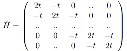

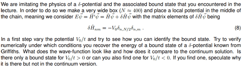

I'm working on an assignment where I'm required to numerically find the energy of a delta-potential's bound state. To do this, we've converted the time-independent schrödinger equation to an eigenvalue problem with E the eigen value, ψ the eigen vector and H a matrix as follows:
with ##t = \frac{\hbar^2}{2ma^2}##.
Now, my specific problem is this:
I've already done all the theoretical calculations, and am just left with figuring out the code. I've tried a bunch of things, but I haven't been able to get the bound state to appear. My code is as follows:

I do not see any place where you are computing an eigenvalue or an eigenvector, unless is is in a procedure that is called somewhere.
Anyway, the type of approach you attempt is quite possibly bound to fail, because of numerical scaling problems and severe roundoff error problems. Your matrix H has a possibly small entry ##t##. It is much better to set ##H = t A## where ##A## is the matrix you would get if you put ##t = 1##. Now, if ##\lambda## is an eigenvalue of ##A## and ##v## is an eigenvector, then ##t \lambda## is an eigenvalue of ##H = tA## and ##v## is an eigenvector (of both ##A## and ##H##). All the numerical work of finding eigenvalues/eigenvectors of ##A## is divorced from the numerical value of ##t##. However, you can just multiply your answer by ##t## as the very last step of you solution procedure, after all the hard work has been done.
According to your calculations, at what is the energy of the bound state?
By the way, it looks strange that are are using SI units for ħ but take the mass and a to be 1. I would use units such that ħ = 1.
It's the action of numpy.linalg.eigh.
Right. That makes a lot of sense (and explains why they're telling my to vary ##V_0/t##.. Changing this little thing gets a much nicer curve, I'll still need to verify if it's the correct curve, but I call this progress :) Thanks!
Edit: Turns out I'm ~2 orders of magnitude off now.. Progress indeed.
That's my doing. I figured I knew ##\hbar## but not the rest so I only kept it in SI units.
According to my calculations, the bound state occurs at ##E = -\frac{m}{2\hbar^2}##. Note how I leave out a factor (as I do in my code) because I don't know how to compensate for ##\lambda\delta(x)##.
