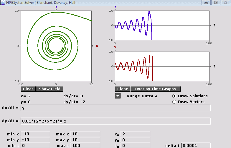

Actually it is: x''-u(b^2 - x^2)x'+x=0
For additional clarity, the problem is presented as follows:
However, my output is a circle about half that radius, that slowly spirals outwards. Setting u to 0 produces an indefinite circle of half the desired radius that otherwise is identical to the given steady state solution. Maybe the teacher miswrote the steady state solution?

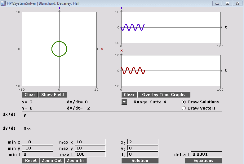

At anyrate, I tried using black box Runge-Kutta software, and the output was the same as my code produced.
The radius of the circle is equal to the distance of the starting point from the origin (I think this is the right answer for part b, along with that a positive u will always cause the solution to spiral away from the steady state analog). So, as shown above, my teacher's solution works if you change the initial condition to a distance of 2.
